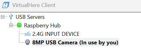

2. Install VirtualHere USB Client on your Windows PC
Download it from:
:link: VirtualHere USB Client | VirtualHere
Launch it, and it will automatically detect the Raspberry Pi on your network.
Double click the camera or Right-click it in the list and select “Use this device”. You’ll hear the classic windows sound when plugging USB devices. ( Note: A USB camera typically can only be used by one program at a time. If it’s already in use by another application, it won’t be available in LightBurn or any other software, until it’s released or the program restarted).
3. Set up LightBurn
Open LightBurn → Windows → Camera control, and select the camera you connected through VirtualHere.
Now you can calibrate it and use all the camera features as if it were physically connected to your computer.

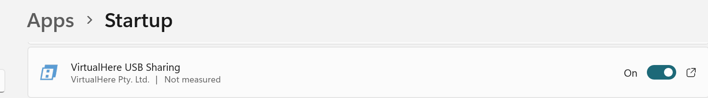

:paperclip: ANNEX 1: Make a Windows Application Start on Boot
  1. Press Win + R, type shell:startup, and press Enter.
  2. This opens your user’s Startup folder.
  3. Paste a shortcut to the program you want to run at startup (such as VirtualHere Client).
That’s it! The application will launch automatically every time you start your computer.

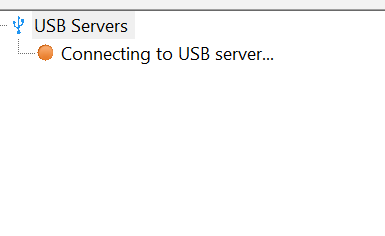

However, it fails to connect to virtual here. It updates with “connecting to USB server” but that message is brief and then nothing until I see the same message over and over. I have deleted Virtual Here and downloaded it a second time and rebooted the PC to no avail. I am on the same wifi network as the pi and am sitting a few feet away from it. No other programs are open or currently accessing the camera.

Here is the log from the VirtualHere Client on the PC
2025-04-21 17:17:25 INFO  :Error 'No such host is known. ' getaddrinfo failed for /home/pi1/vhusbdarm:7575
I must be missing something but I have the same error as I had when attempting to run it on the bridge pi as well.

Hi! Thanks for the detailed message and logs — that really helps.
It seems to me that VirtualHere Client on your PC is trying to connect to a file path (/home/pi1/vhusbdarm) instead of a network address. The server must be running on the Raspberry Pi, and the client must discover it over the network.
Here’s how to fix it step by step:
:white_check_mark: 1. Start the VirtualHere Server on your Raspberry Pi
You’ve already downloaded vhusbdarm. Now, you need to run it:
./vhusbdarm &
That & at the end means it runs in the background.
You should see a line like:
VirtualHere USB Server for Linux - Trial Version
:light_bulb: If you want it to run automatically every time the Pi boots, I can guide you later on how to create a systemd service for it, but you already have it in the above guide.
:white_check_mark: 2. Ensure Your Pi and PC Are on the Same Network
From your PC, try this:
ping raspberrypi.local
Or use the Pi’s IP address that you already know. If ping works, then the network connection is okay.
:white_check_mark: 3. Open the VirtualHere Client on Your PC
Once the server is running on the Pi, open the VirtualHere client on your PC.
If everything’s good, it should automatically discover the Raspberry Pi server and show something like:
Devices available from [Your Pi’s IP or hostname]
If it doesn’t appear, right click on “USB Servers > Specify USB Servers > Add” and add your Pi’s IP address, for example:
192.168.1.101
:warning: DO NOT add something like /home/pi1/vhusbdarm:7575 — that’s not a valid network address.
ALSO: Check That Port 7575 Is Open on the Pi
On the Pi, after starting the server, you can check if it’s listening:
netstat -tuln | grep 7575
tcp        0      0 0.0.0.0:7575        0.0.0.0:*           LISTEN
Let me know how it goes! Once it connects, your USB camera (or any other USB device) plugged into the Pi should appear in LightBurn just like it was plugged directly into your PC. Let me know how it goes! :wink:
Ok, great news, finally. The pi newbie on the other end of this conversation (me :sweat_smile:) finally has the camera connected.
I noticed I had to type
sudo ./vhusbdarm &
to start the server running on pi1. I also had to manually enter the network address to get connected on the PC side. I am not sure how I ever got started entering a file path :flushed_face:
Anyway, I do have VirtualHere running in my startup folder.
Closing the terminal on the pi breaks the connection and since the pi and mouse are painfully slow, I would like to proceed with ANNEX 2 I have completed step 1 and updated the path in step 2 to reflect the information for my pi

What I still don’t understand is why is the connection broken when close the terminal window on the pi?
When I type the command to run the server it restores the connection. I am getting closer! Thank you very much for all of your continued help and for providing this much needed feature!
