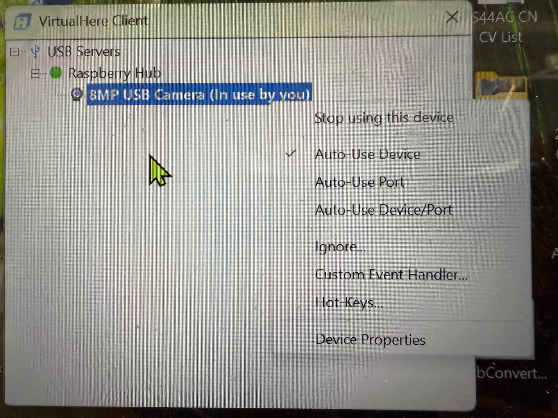

Worth Noting
When you locate your camera in the Virtualhere Client on your desktop, if you right click on it, you can choose Auto Use for the camera by default. I have also noticed an 8s delay when sending commands (frame, pause, etc.) to the laser from Lightburn.
