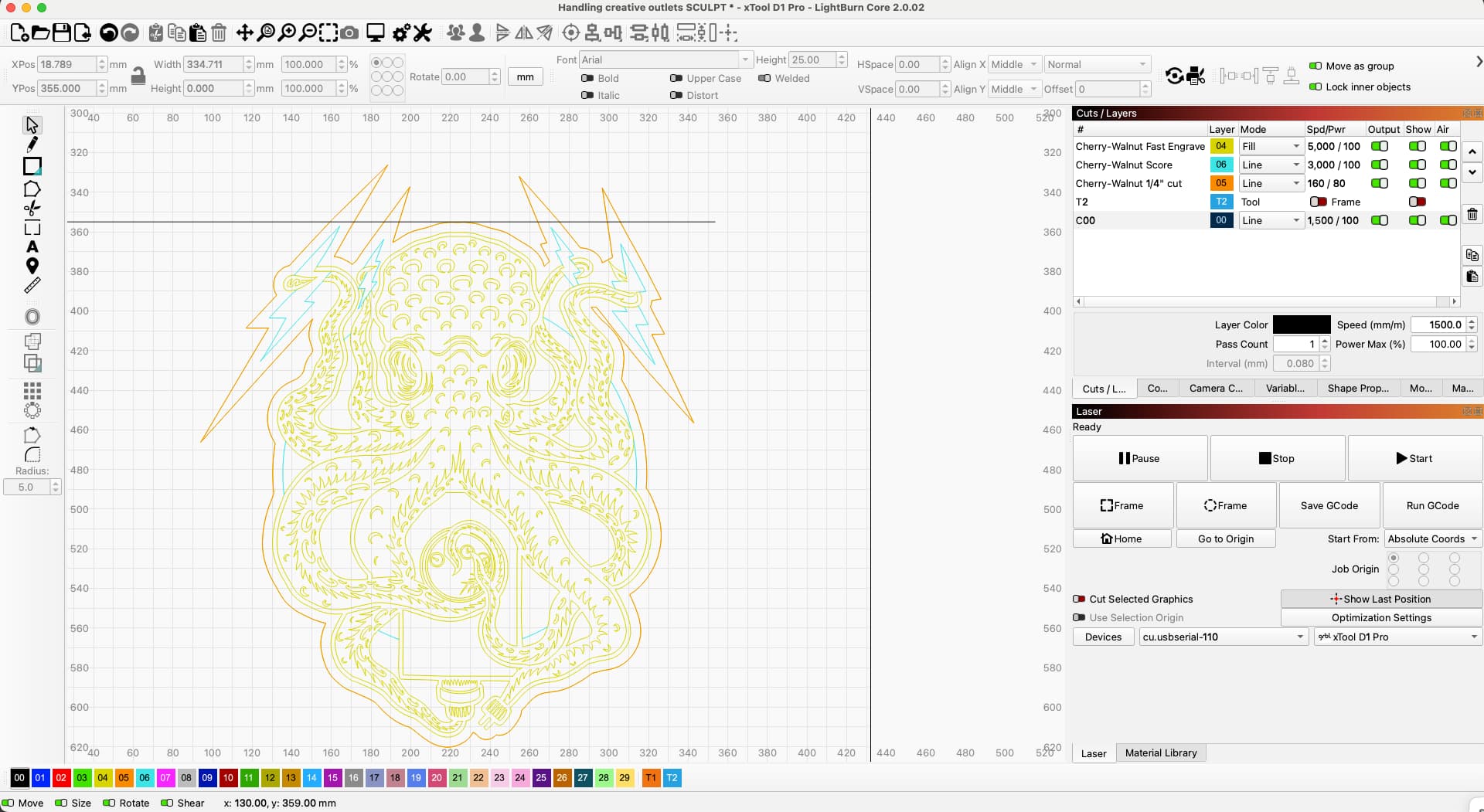

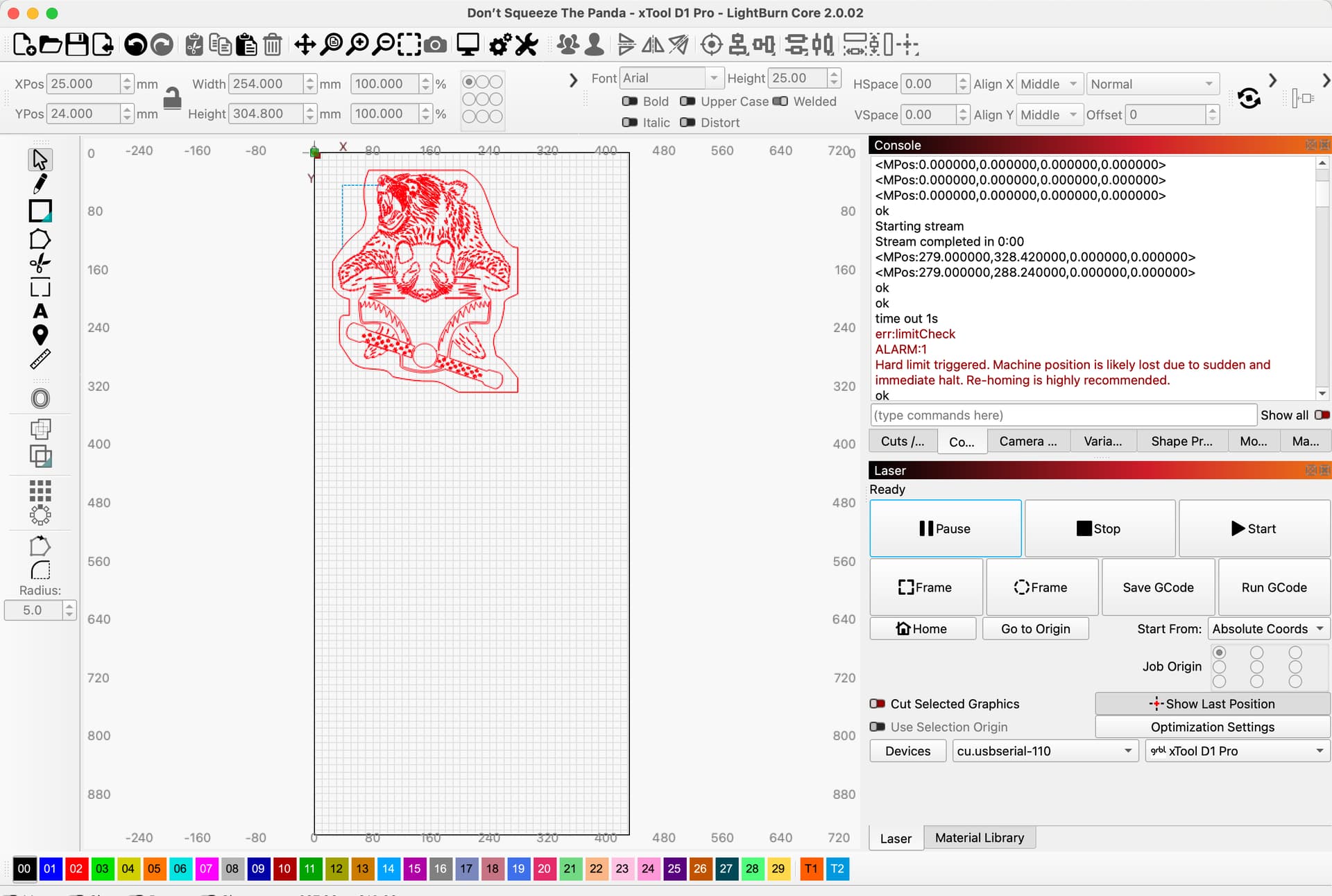

Hi all,
Long time lurker and recent convert to LightBurn. Loving all this program can do, but regularly get the “Hard Limit Triggered” both when I’m Framing and during a 4-6 hour burn. It’s seemingly random to my layman brain - sometimes it doesn’t trigger during the Framing and it seems to trigger at different spots X and Y positions.
I’ve read through a bunch of other “Hard Limit Triggered” posts, but still cannot figure out how to solve my own issues with this, and hoping one of you can.
To be certain, my designs are at least 24mm in from the boundaries (though I’m noticing the trigger seems to happen when the laser is more in the middle of the work space), and I’m using Absolute Coordinates.
Here’s a screenshot of the latest project that triggered this.
 ![image](https://forum.lightburnsoftware.com/uploads/default/original/3X/d/b/db6acfab4c73fdbc1777da077c6b90bfa47f2c8a.jpeg)
Here’s where the latest error happened while I was framing this project. Thanks in advance for any help! This forum has been really useful and I really appreciate the community here.

How old is the machine? You could have a limit switch going bad. These switches are usually wired Normally Open, but a N.C. loop with a loose connection can cause this.
Another possibility is there might be an intermittent short between a pair of wires running to one of the switches.
If your machine has a flame sensor, this could be giving false triggers (bright light) but I would expect an Alarm 3 here. xTool has its own way of doing things.
The final possibility is that you are using Current Position or User Origin instead of **Absolute Coords** for your Start From choice.

Thanks for the quick reply!
The machine isn’t more than 1.5 years old. I don’t use it regularly, either. Is there a way for me to test the limit switch without buying a new switch?
The D1 Pro has a flame sensor though, but I’ve got the laser in a box w/ windows, and bright light generally doesn’t reach it. It happens day or night, too (eliminating the possibility of sunlight triggering it).
I have Absolute Coords selected, yes.

> [@creADDive](#):
xTool is not GRBL friendly but you can try. Enter **?** in the Console window and see if it reports something. It should start out with **\<Idle | MPos:** if it works for you. If it does, copy and paste it in a reply.
Do it before you start, and again when it stops with the alarm. Copy and paste in a Reply.

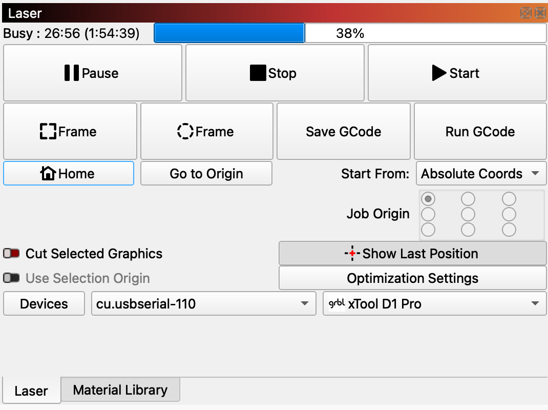

I got around 40% through a 25 min. project when the Hard Limit Trigger set off. I had **?** sitting in the command window so I could hit Return as soon as it triggered, but it doesn’t look like it got the **\<Idle | MPos:**
I appreciate your help, really. Do you have any other suggestions?

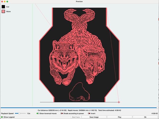

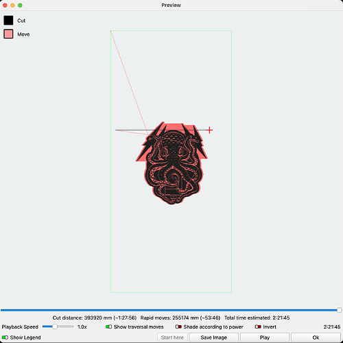

What happens if you place your shapes in the center of your workspace?
Can you show us what you see in your Preview window now? (Alt+P)

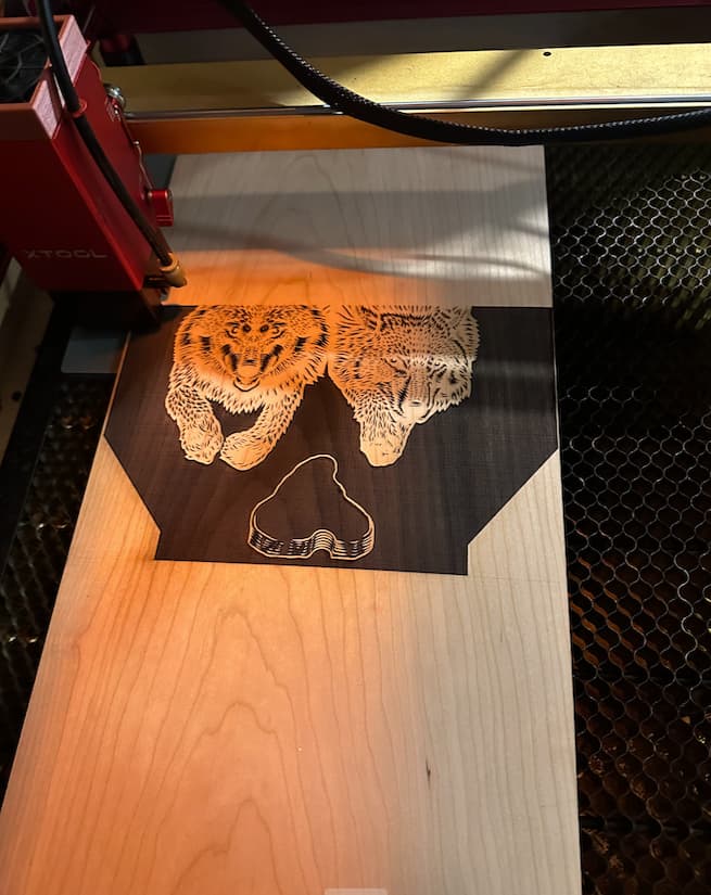

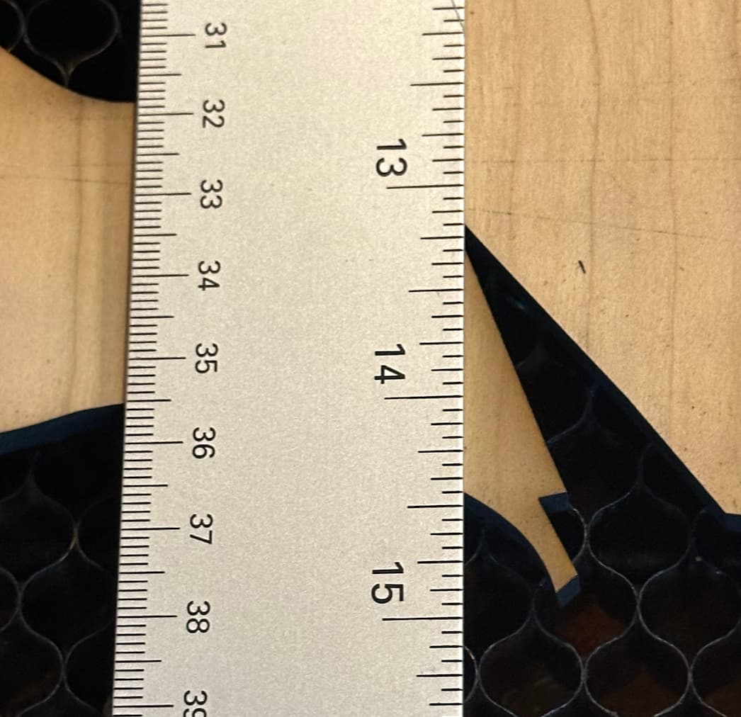

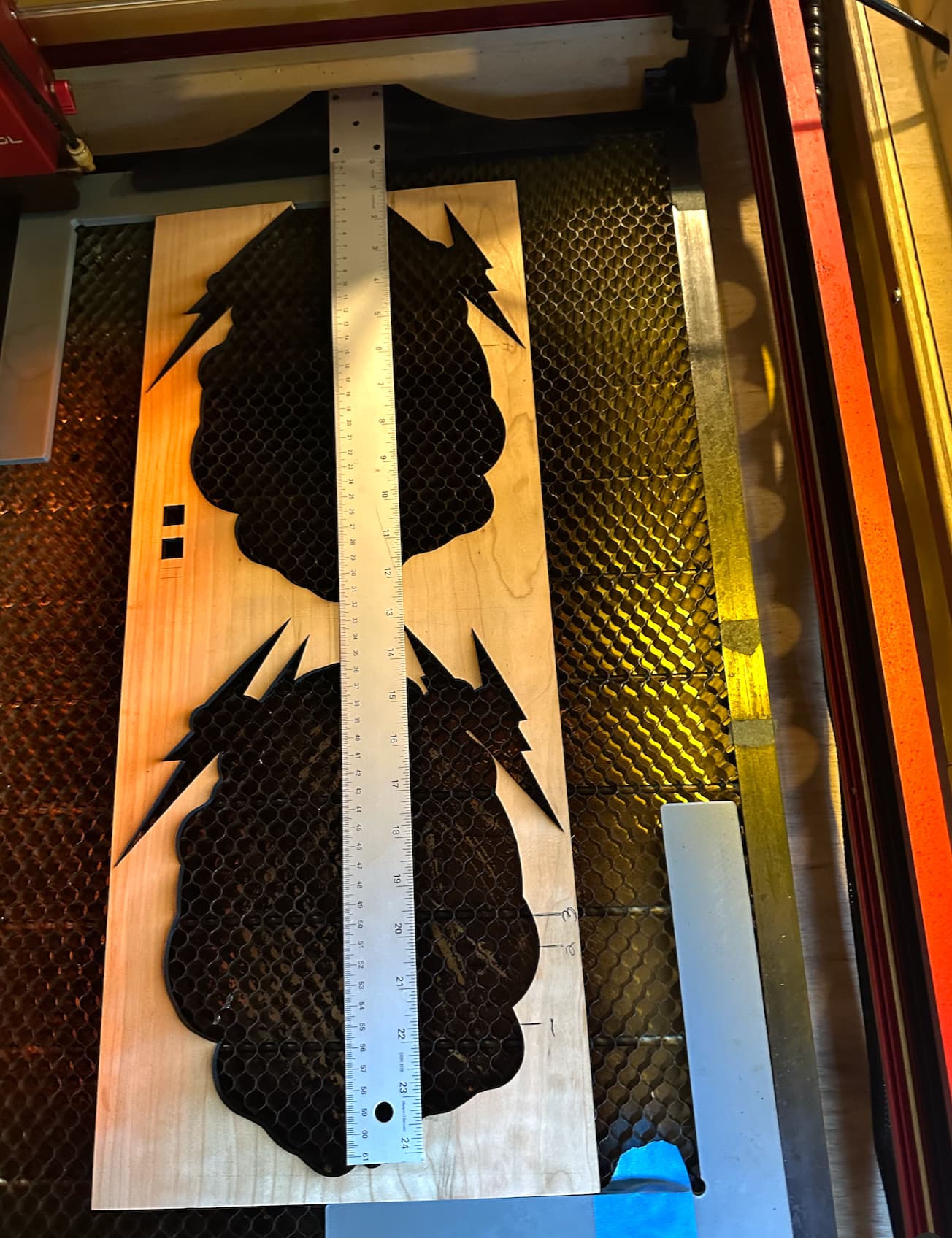

It seems to trigger the limit alarm when things are in the middle, also. Here’s a piece I started this morning. It went around 2.5 hours before triggering the limit alarm. This is what the preview window looks like.
 ![image](https://forum.lightburnsoftware.com/uploads/default/original/3X/9/9/99df676c8d22c6d46fa3b2856522ad5b047d5952.jpeg)
And this is how far it got before the hard limit triggered alarm went off.
 ![image](https://forum.lightburnsoftware.com/uploads/default/original/3X/4/e/4e09db983b7e2a47b47a4a9e5c7bf29c94efeea1.jpeg)

It would be better if you answered the questions more clearly. Such as, is the work piece you have, arranged in the middle of the machines work area in the left/right or X axes?
I agree with @soniclab that you should move your work piece to the center of your work area, at least along the X axes.
In the preview, I can see the left side of the work area (green line), but are you centered within the X direction work area?

Oh, I understand now. Sorry, you are correct. The pieces are more left aligned. I’ll move the material to the center of the machine and give it a go. I have L-bracket magnets that square the material to the honeycomb, which is why I had the material more to the left of the workspace. Thanks both for the suggestion!

Moving the material to the center of the work area did it!
Those clips I was using were definitely one issue, but once those were taken off I was getting the Hard Limit Trigger. Not anymore - I just completely the first 5.5 hour continuous burn since owning this.
Can’t thank all of you enough! Really appreciate the quick responses and clarifications.

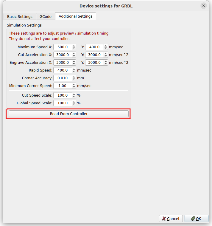

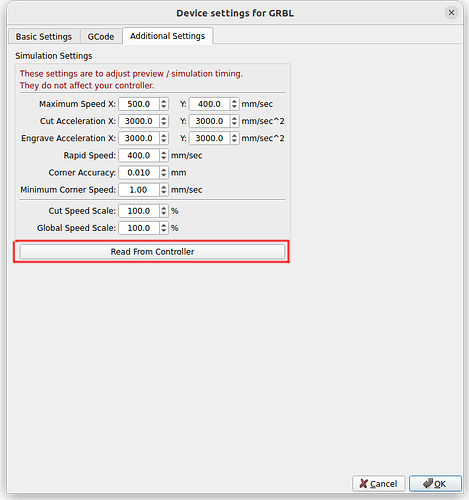

**Post date:** [August 17, 2025, 7:24pm UTC](https://forum.lightburnsoftware.com/t/hard-limit-triggered-in-the-middle-of-the-work-space/177625/12 "2025-08-17T19:24:29Z")
</div>

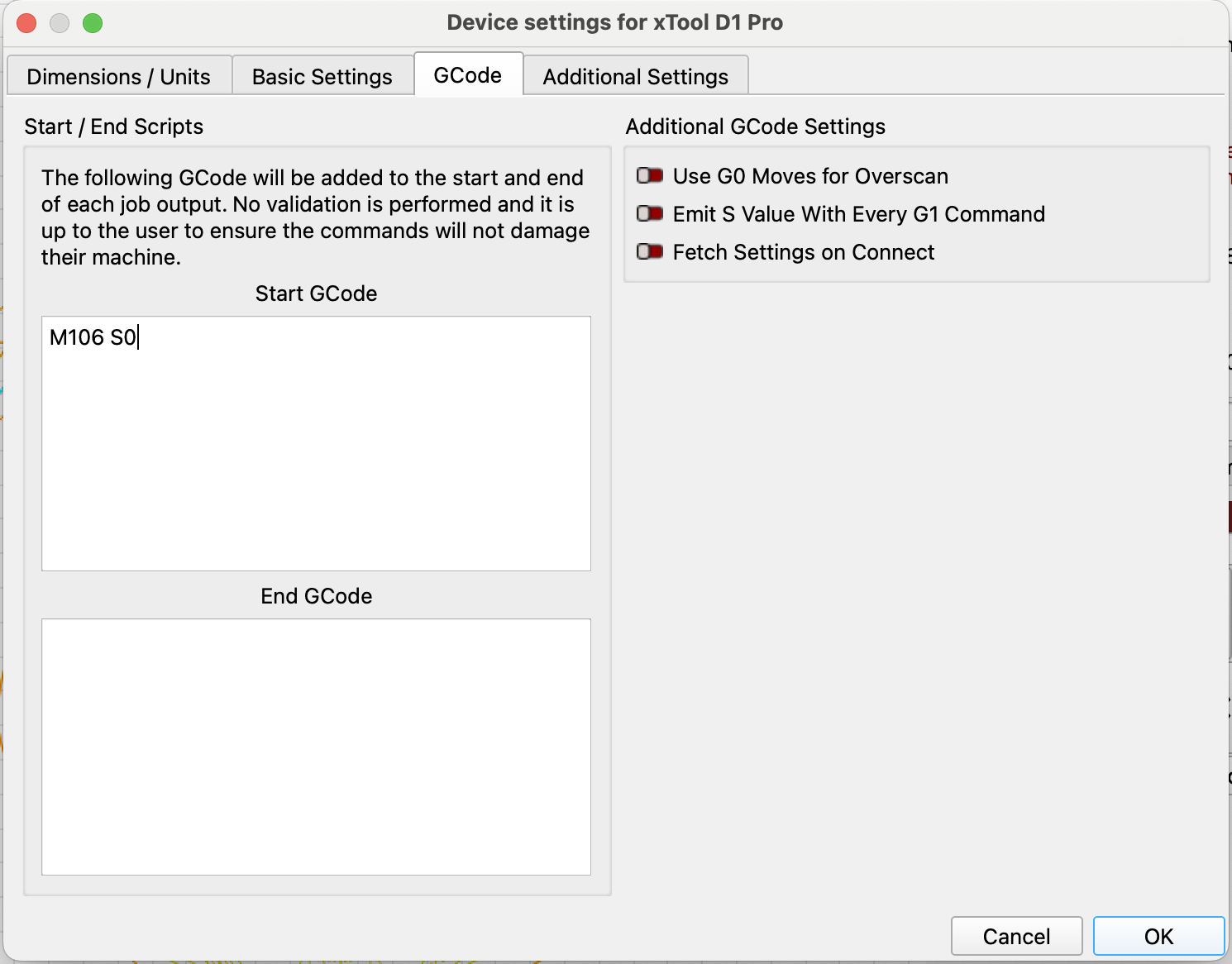

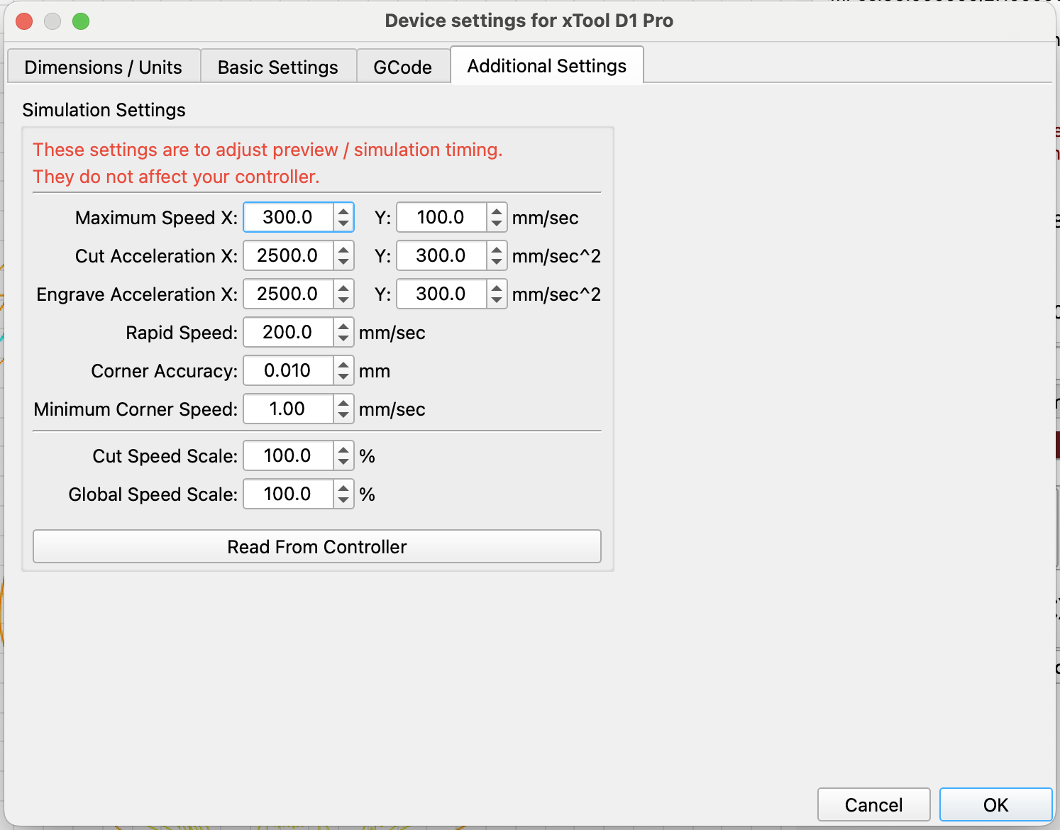

It means something isn’t correct with how the machine is being emulated on your machine. The controller values might need to be updated.
This is usually in the _ **Edit → Device settings → Additional settings** _ and click on read from controller.
 ![image](https://forum.lightburnsoftware.com/uploads/default/original/3X/4/0/40c8038654f5b91046364a504d27d517b3ac4ad1.png)
I use Lightburn V1.7.04

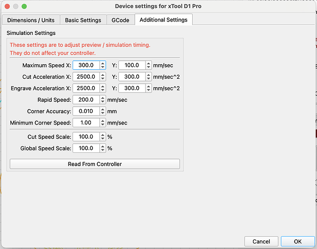

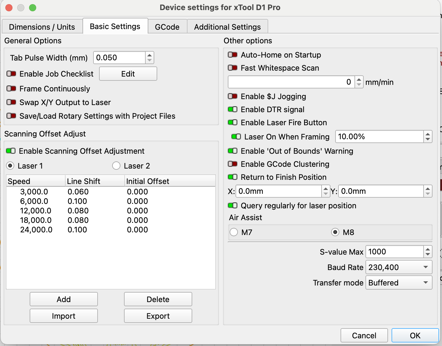

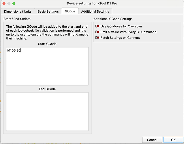

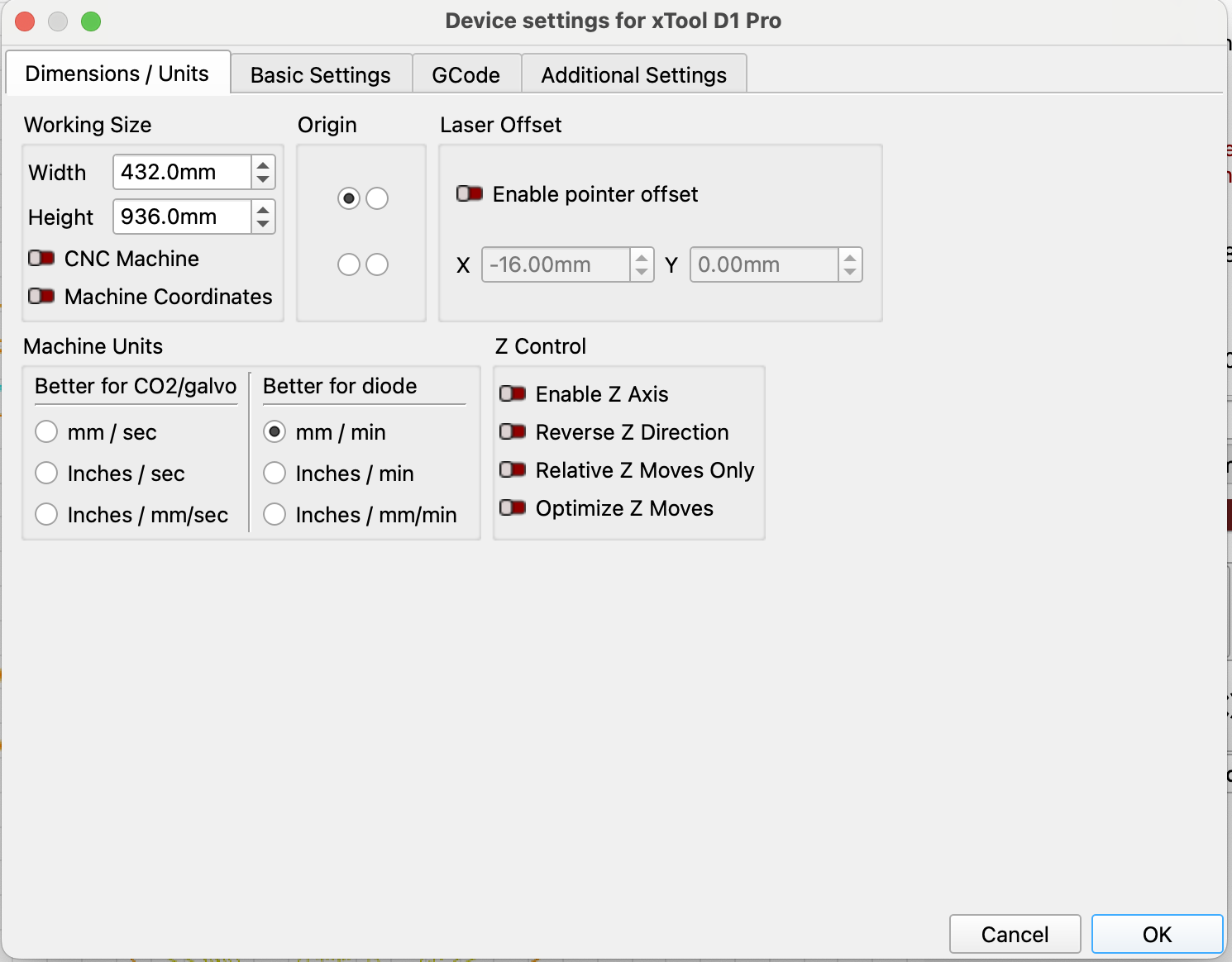

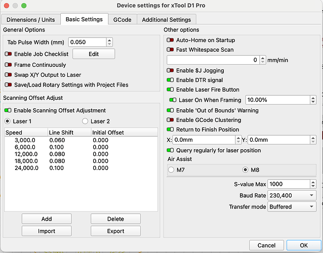

Guess I spoke too soon. After knocking out the project mentioned above, I’ve been getting the Hard limit triggered alarm continuously again. I’ve moved the material to the middle of the work bed each time as instructed. I also updated the controller values as you described, but got the error again shortly after restarting the job from the failed position.
Should I be restarting the machine after the alarm and re-homing the laser? Very frustrating again.
I’m using Lightburn Core 2.0.02
Pasting in Device Settings for my xTool D1 pro with the extension rails in case something looks fishy to you. Thanks again for the help! Greatly appreciated.
 ![image](https://forum.lightburnsoftware.com/uploads/default/original/3X/a/e/aeef88df55ddace94bd6d4fbd1e7919c40268dc7.png)
 ![image](https://forum.lightburnsoftware.com/uploads/default/original/3X/8/5/85491e7f7fc47eb9afe253178185c3348cbd6a0c.png)
 ![image](https://forum.lightburnsoftware.com/uploads/default/original/3X/8/9/89f9676b1543da237ef63b5d7d9b5360794ae088.png)
 ![image](https://forum.lightburnsoftware.com/uploads/default/original/3X/6/7/674c0d596a6c3a3c01c1101f401a4772fe426f79.png)

In the laser window, there should be a _ **start from** _ and a _ **job origin** _. A screen shot would help with this.
<div class="post-metadata">
**Author:** ![creADDive](https://forum.lightburnsoftware.com/letter_avatar_proxy/v4/letter/c/58f4c7/32.png) [@creADDive](https://forum.lightburnsoftware.com/u/creADDive)\
**Post date:** [August 22, 2025, 5:26pm UTC](https://forum.lightburnsoftware.com/t/hard-limit-triggered-in-the-middle-of-the-work-space/177625/15 "2025-08-22T17:26:50Z")
</div>
Sure thing. Here you go.

How does this look in preview?
Using absolute coordinates, it should show up on you’re workpiece in exactly the same place you placed it in your workarea on the screen.
Might include a screenshot of your whole screen with the layers visible.

Thanks, Jack.
I drew this black line at 355mm in the main workspace of Lightburn, which is almost exactly where it is vertically on my machine.
 ![image](https://forum.lightburnsoftware.com/uploads/default/original/3X/9/3/93620baccc1a3a23871d94419dbdbabe69df2563.jpeg)
 ![image](https://forum.lightburnsoftware.com/uploads/default/original/3X/5/f/5f232f846ac996e67432b7f7a6b574f89552d23a.png)
Here’s how it sits in the actual work space. I put the square edge as close to where the laser is homed as possible, but the top I was measuring in the preview is measuring roughly 35.5cm. I also put dash marks to the right of the cutout in the 4 different places I got the Hard Limit Trigger (3 on the bottom, 1 on top). Note that I cut out the topmost last night, and got the 1 Hard Limit Trigger, and cut the bottommost today and got 3 more. The bottommost is what matches the preview screen above.
 ![image](https://forum.lightburnsoftware.com/uploads/default/original/3X/f/6/f663084af8a93ce5dbf2c655366573cad5c5ac86.jpeg)
 ![image](https://forum.lightburnsoftware.com/uploads/default/original/3X/e/f/ef00494dd4c39f128d36b80f4ef4d656fe197b6f.jpeg)
**Post date:** [August 22, 2025, 7:47pm UTC](https://forum.lightburnsoftware.com/t/hard-limit-triggered-in-the-middle-of-the-work-space/177625/18 "2025-08-22T19:47:57Z")
</div>
A hard limit usually means you have tripped a limit switch. Does it move anywhere near the limits?
You might have a faulty switch that the machine movement is causing to be an intermittent.
