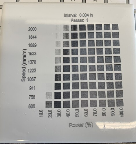

Have weird material rest outcome
The picture on the right is the settings for Lightburn Material Test. The one on the left is the test outcome for Norton method white paint white tile. Normally the test outcome gets darker to the right and down. Here, on the test outcome, it is darker more on the left!
Possibly just burning the titanium down into the tile.
600mm at 30% looks the best.
Normally you’re just burning wood or some other material. So more power generally relates to a darker burn.
With TiO2, it appears to vaporize or doesn’t bond well, so it lightens up. I get this with the co2 and fiber if it’s too hot.
The best way is to look at these with a magnifying glass or microscope so you can see the actual effect to the TiO2. You can figure out what’s happening.
