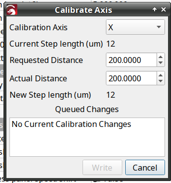

What I’m seeing is that the laser pointer will be at 0,0 I’ll place a ruler under it and bump the jog twice. Where ever it lands I took a measurement on the ruler and what the X axis said in lightburn.
Laser pointer stopped at 100mm on the ruler but light burn shows it’s at 144mm.
With that being said… the roller calculation is wrong so when it travels down the gantry. It’s thinking it’s going further than it actually is… which is why is stops short of going the full length of the print bed.
So it’s like 44mm off at 100mm

Set the jog distance to a simple value like 100 mm to eliminate one variable.
Does the machine have a red dot pointer? If it does, even if the dot is not aligned to the beam, use the dot to mark the distances. If it doesn’t have a red dot, cable-tie a stick to the laser head.
Set the end of a good scale / ruler at wherever the dot / pointer is now. Jog 100 mm and measure where the dot / pointer ends up on the ruler; this will require a few iterations to align the ruler parallel to the axis travel.
Suppose you tell it to jog 100 mm, but it actually moves 66 mm. Feed those values into the LightBurn Axis Calibration tool:
Write it to the controller, iterate a few times, and you’re done.

I just wanted to thank you for the help on this. This did correct my bed size issue.
