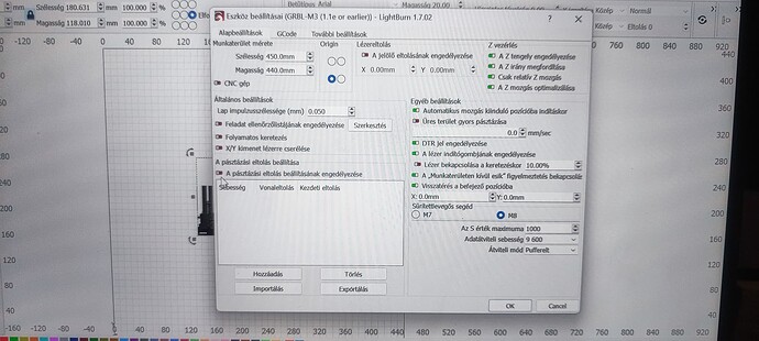

Can you post images of:
a) full screenshot of LightBurn
b) Edit > Device settings

And in the consol said Waiting for connecton put i put the cabel in the laptop and this is not a problem before why can be now?
Your profile Baud rate is incorrect, also you have GRBL M3 where it should be GRBL
Click Devices > Delete the profile > import the one I am uploading here
Longer B1 40W.lbdev (954 Bytes)
Thank you i am trying what you said but what is the good Baud rate ?
Hello thank you it connect now but it is still weak to engrave anything it can be the BAUD think you said?
No it is not it is now 115 200
