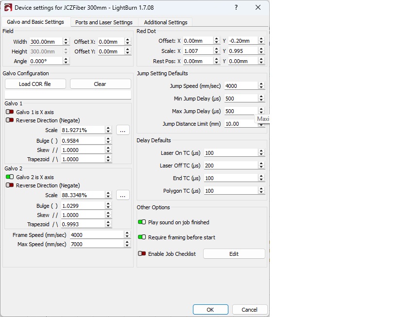

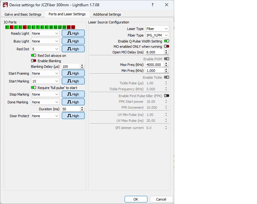

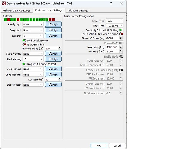

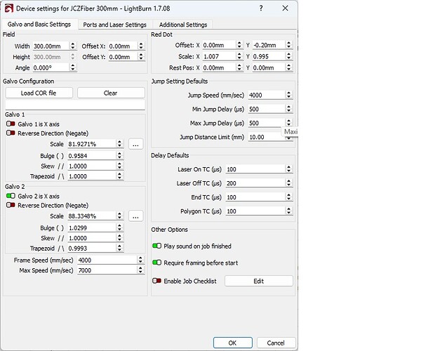

I have an issue where the laser works perfectly in beginner mode but seems to lose all power in regular mode. I cannot figure out what settings is causing it to run this way. I tried updating from 1.7 to the newest 2.0.4 hoping it would resolve itself but it is worse in 2.x. The laser won’t work in either beginner or regular with 2.x.
Machine details:
100w JPT M7 E2 MOPA laser
BJJCZ EZCAD control card
Sino RC1001 Galvo Scanner
I am attaching screenshots of all the configuration pages I can find as well as a video link showing what it is doing in both modes. (https://youtube.com/shorts/oNoIZRgu2CM)

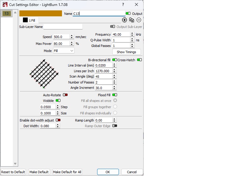

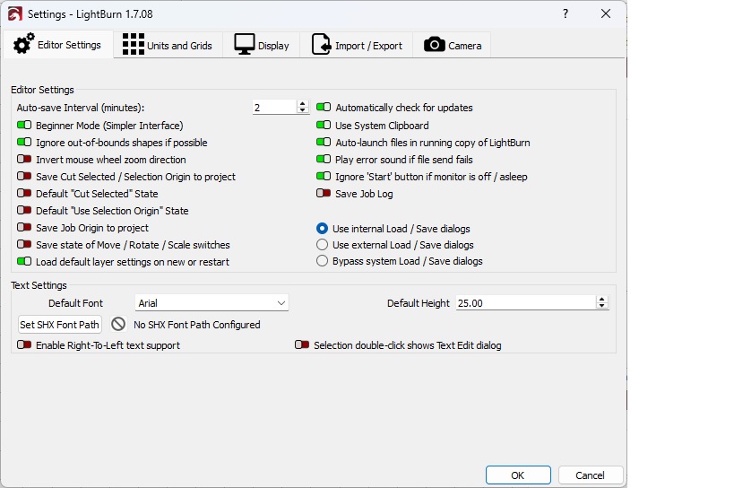

Are your screenshots in beginner mode or advanced mode?
Just a WAG, in beginner mode it probably ignores the Q-Pulse = 1 and runs it at a more orthodox setting.
Try using Q=200 to confirm or eliminate this as a contributing factor.
You are Amazing! that took care of the issue.
However at 200 the engraving is a little different and these are printing plates so I had them dialed in perfect under the beginner mode. Do you know what the Q pulse setting defaults to under beginner mode? Or do you know where I can check that?
Bryan
My bet is 200, that is the fixed for a JPT. Other brands are around 90-130. But also beginner might ignore other settings, you have wobble on that might make a difference. Also flood fill might get ignored. I’m not one of the gurus, just a casual observer.
