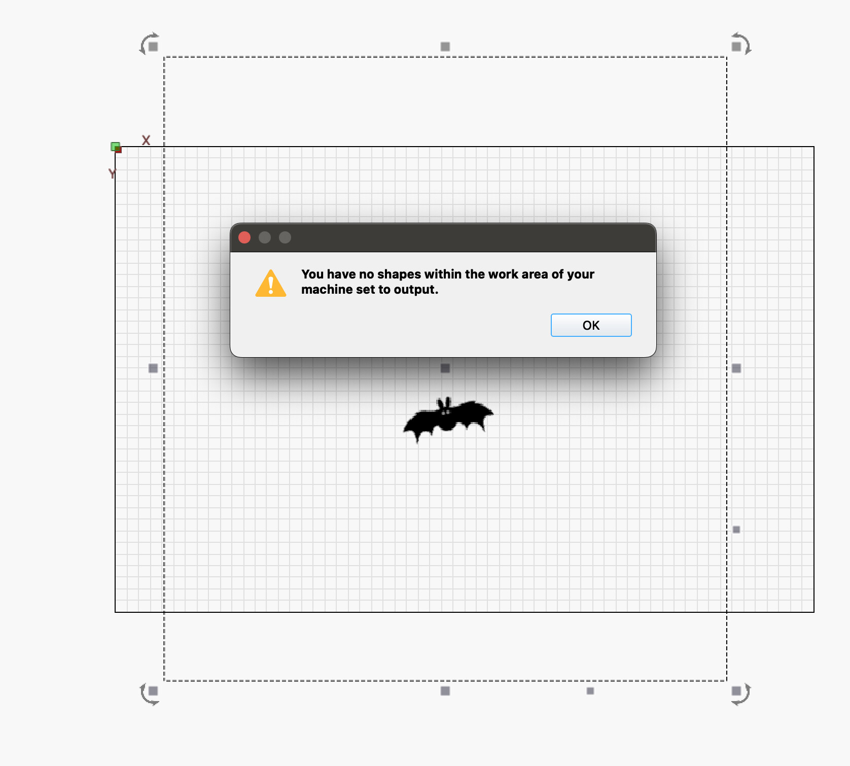

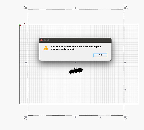

HELP Image extents problem with workspace
The only pixels that have data are within the workspace.
The image has a huge square around it (though empty) and the software is viewing that as burnable area (it’s not)
It continues throwing these errors, and is asking that I keep shrinking and shrinking the image down.
I cannot get it to burn and have no way to remove the rectangular extends.
This seems like a HUGE bug to me…

If there is a frame, it is not treated as “empty”. This is not a software bug, all other graphics programs treat frames in the same way.
Without an attached LBRN2 file, it’s a guessing game.
First step would be to explode/ungroup the existing image. You should see bounding boxes in “blank” zones and be able to delete them, reducing the overall project footprint.
If you have separate layers, you can select any given layer with shift-click on the layer number in the cuts palette and find other locations of concern.

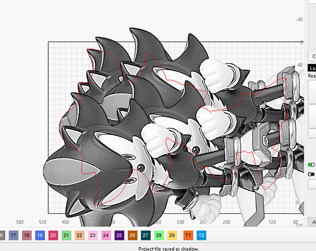

Here is the file I am attempting to burn.
Here is my LBRN file though it will show you nothing.
shadow.lbrn2 (445.6 KB)
The issue is that transparent data on an image is being treated as data. That is the problem.
The rectangular extents of an image should have absolutely ZERO impact on what is able to be burnt on the workspace. Everything outside that range should be ignored.

You are correct. Lightburn is using the entire size of the graphic. Make a new, smaller rectangle around the image and use it to crop.
Now it does not exceed the work area.
“You are correct. Lightburn is using the entire size of the graphic. Make a new, smaller rectangle around the image and use it to crop.”
Appreciate your reply.
I get that, however that is not always possible due to some projects needing the entire workspace to be burnt with an image, and some of the images extents (data or no) being otuside the work area…this really is a bigger problem I believe than people are dismissing it as. I had addressed this “solution” in my 3rd or so reply. This will only work for this instance because of the perfect 0/90° angle of the image being perfectly in the center of my bed…it normally isn’t like this.
In that case, uncheck this and try it.
Holy lord YES
