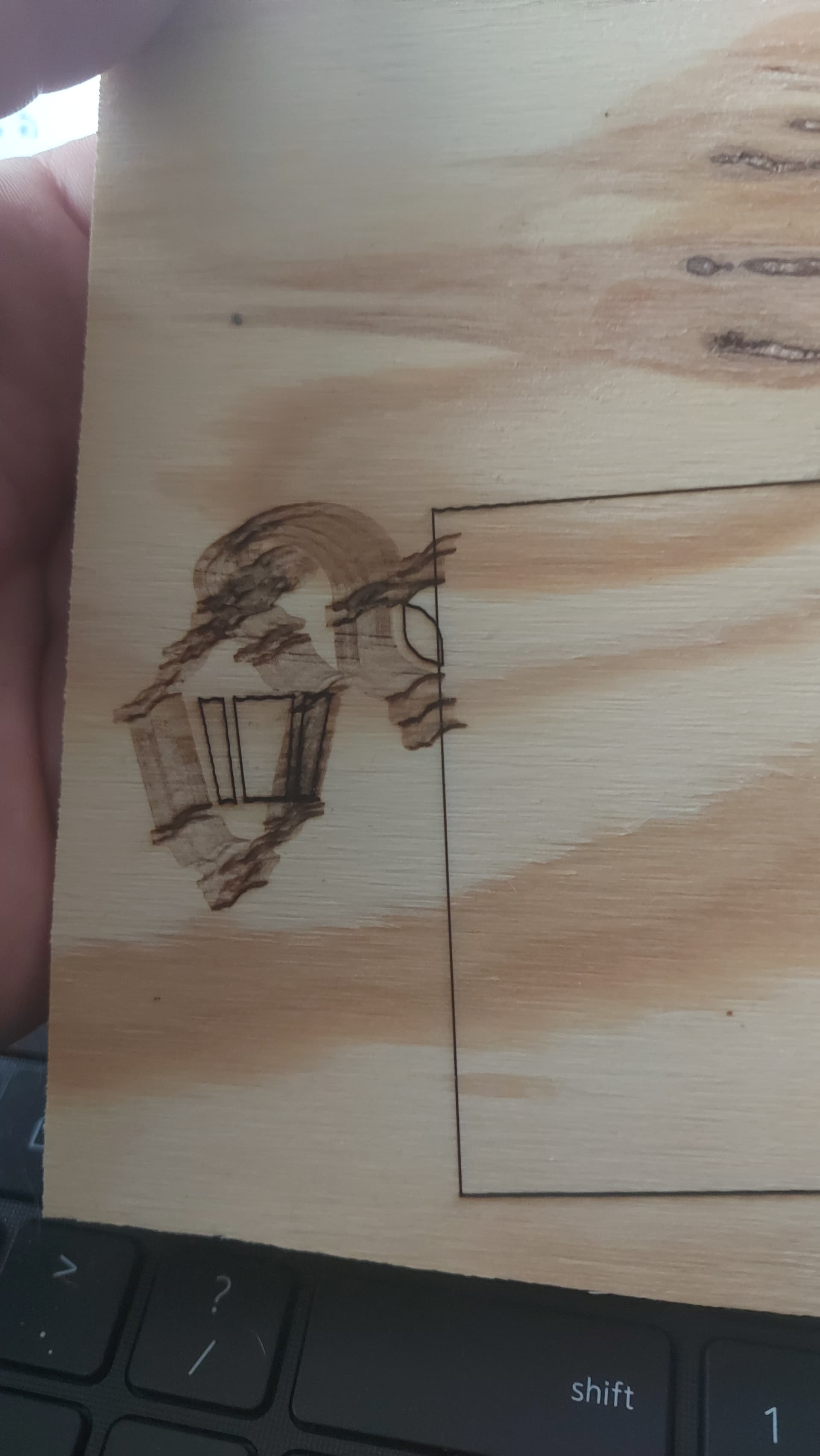

Help lightburn bug or what?
Some help plz?
Help on what? For anyone to help we need more details. Copy of lightburn file, type of laser, screen shot of settings.
Without knowing your expectations, we cannot interpret you outcome.
Instead of plywood, I suggest you use cardboard from shipping boxes to learn the process. Much lower power is needed, but free material is a lot better to make errors on
Your X axis has a problem with the timing belt or loose pulley/pinion screw.
