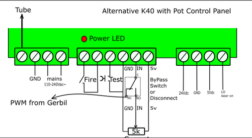

Do you have a pot on this? Sometimes this is used to set the maximum current limit and then the pwm works like it does on an led, turning it on and off.
Can you post a link to the board and your machine?

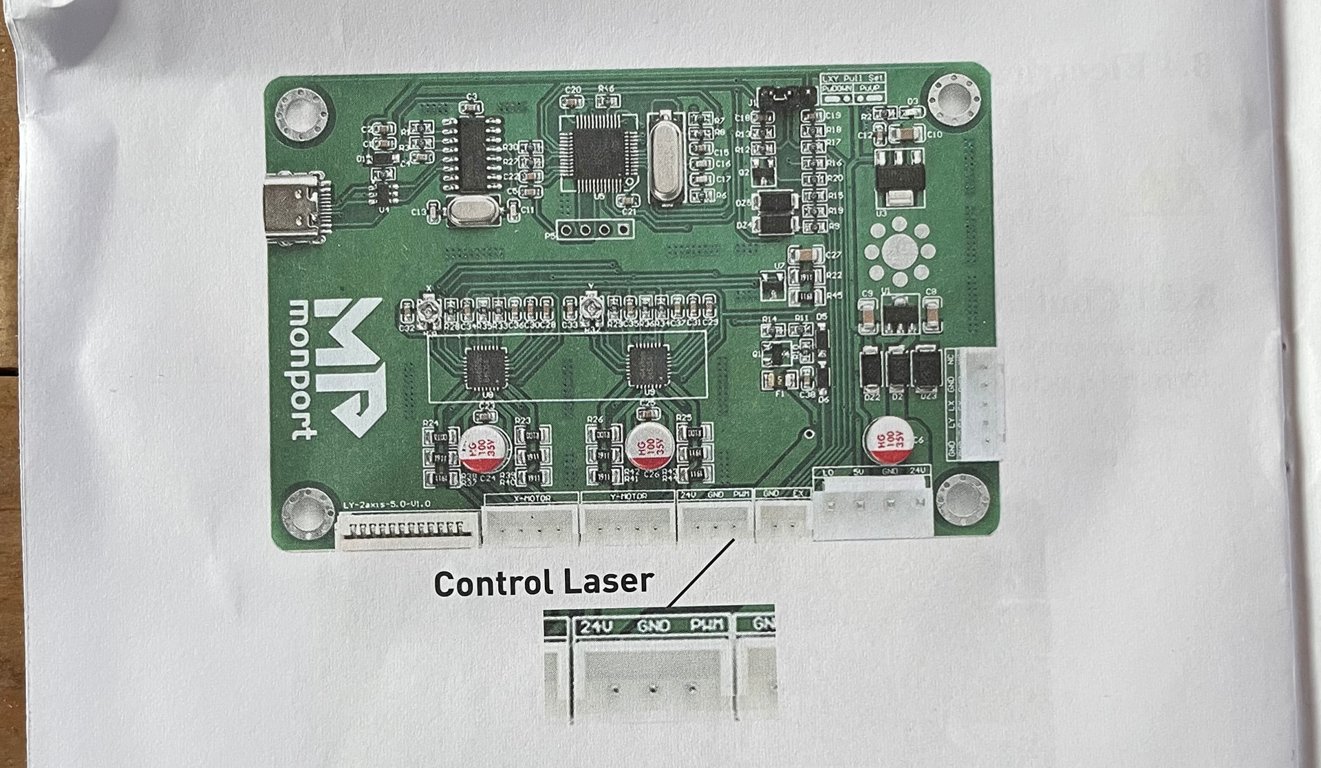

Monport board

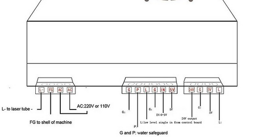

This machine has a type 1 power unit which doesn’t have a connection for the PWM laser control line.
I have gotten the laser to work by connecting the PWM wire to the IN socket of the PSU and the black wire to ground.

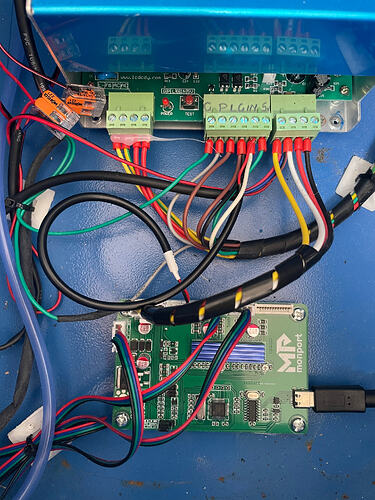

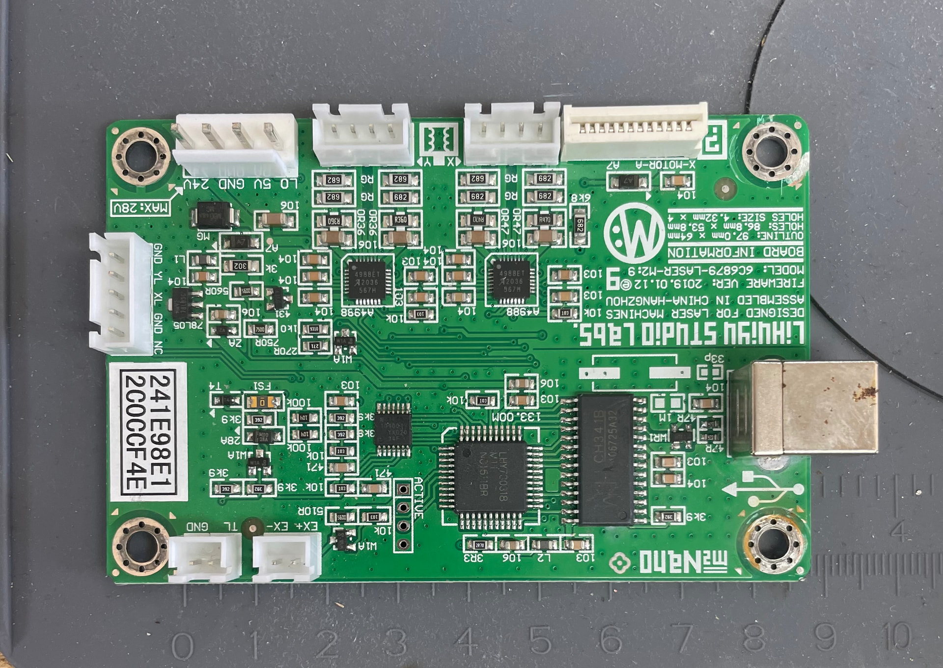

Can you post pictures of the current and previous controller/psu/wiring setup? There are some different configurations of the K40 over the last decade+
Thanks for your interest. I haven’t got a picture of the old set up. But I’ve uploaded the old card.
The psu is an old type 1 with the laser control line connected to IN and GND
What is the white wire on the “IN” port connected to? Presumably the Pot, in which case you will have issues; it’s either/or for this configuration. You can also connect the PWM out from the board to the “L” port, and keep the pot on the IN to get the “hybrid” kinda situation, where the pot keeps your power limit, and the PWM signal regulater the firing. I think that’s what you had with the first slop machine output.
It’s important to note that the K40 “L” signal is active low. Did you go through the relevant steps on this page GRBL Configuration - LightBurn Documentation for setting up the GRBL board? Double check that laser mode ($32) is enabled.
Do you have a link to the instructions for installing this board? This is from the Makers forum and is a different control board but you can use the connection to ensure yours is correctly wired and you understand the difference.
The pwm is required, one way or another, so there is a place. Hopefully the link will get you around this, The only question I have is if the pwm signal is inverted before it goes to L of the power supply.

There are two ways to connect these. One allows the software to control laser current, the other, sets the current at maximum, then it’s turn on and off with the pwm, like a diode laser.

This is all I got with the board
There wasn’t a control line connecting my previous board to the psu.

Here’s a power supply with names on terminals.
You can look at the image I posted before that shows how these are wired.
You need to have a laser enable switch on your console, so it can’t laser unless the operator enables it. The pin names are the same and do the same thing.
