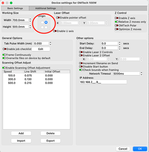

If you changed your machine origin position in device settings to the wrong corner it will print mirrored, flipped or both depending on which corner you select. Typically it should be left front corner for diode machines.
If you are talking about G53, I have not touched nor have I seen any clear explanation on what it should be set for various preferences, in case I or the machine changed its setting by mistake.

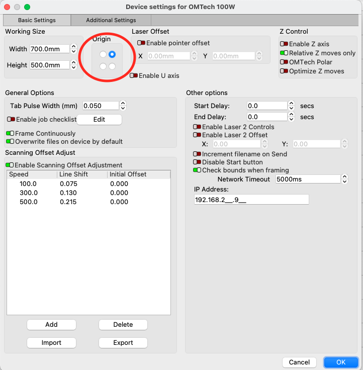

Im talking about this setting. I don’t speak G, LOL. This is my C02. For my diode the setting is Lower left.
I see, so with that set that way which direction will it printing when say you print a material test test from Laser Tools->Material Test, will it print starting from near you and advance to the back of the machine or visa vasa, How about when printing the individual lines within a box, does it start left->right then left again for the next line within the individual box?
The machine origin controls how it interacts with the coordinate system. That is the HOME position and will never change.
The job origin is a user defined / changeable parameter in the laser panel. CNC machines sometimes act different than a dedicated GRBL Laser machine. Whether or not you have limit switches makes a difference as well. There are other users that are well versed on using a laser on a CNC. I only know what I’ve read from others regarding that.
