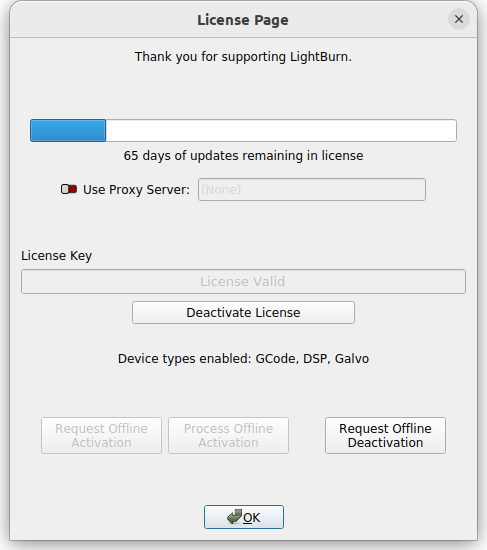

You can navigate to Help → License Management this will tell you what state(s) are enabled in the software…
Glad you have it worked out… The problem smells like a driver…
