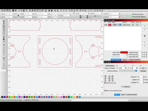

Ok I got the Tab part figured out I think. Still having problems with the slots. I watched the lightburn video on it again and I think I’m doing what it says but its not giving me a good result.
I measure the original slot width…
 ![image](https://forum.lightburnsoftware.com/uploads/default/original/3X/3/a/3a97daeba307b79a2c42703a2a35210b2ac2396d.png)
I go to Tools - Resize Slots in Selection, I put in the slot width that i measured and it finds all of the slots. I put in my new material thickness…
 ![image](https://forum.lightburnsoftware.com/uploads/default/original/3X/3/7/37158f6f99d2ceccff479f774bd2a6d7718fa99d.png)
And this is the result I get…
 ![image](https://forum.lightburnsoftware.com/uploads/default/original/3X/a/6/a65bda8c57b933e89f2a9b041c09087c715b47e1.png)
I don’t understand what it is that I’m doing wrong. It worked great for the tab height and moved those exactly. Hopefully someone can see what I have done wrong and guide me the right direction. Thank you!!!
Edit… I got it to work, sort of. I did the math and figured out what percentage it was over shooting on my input, reduced my input from 5.15 down to 1.362 which had the blue arrows showing it making the slot narrower, and once I hit ok I ended up at 5.148mm It makes no sense why I had to do all the math to get it to work right but it worked. Hopefully someone will see something I did wrong and it will be much easier next time

> [@bernd.dk](#):
> There is a little mix in your original measurement, but there is no need for a calculator if just the start and the end result is inserted correctly.
> Kerf compensation should always adjusted in layer properties
> that is missing one, sorry
No need for sorry, I’m trying to learn. I have my kerf offset correct in the layer section…
 ![image](https://forum.lightburnsoftware.com/uploads/default/original/3X/6/6/6638b0218e4a93262255adfd6c871f8395174420.png)
The tab length works exactly as I expect it to. But when I go to sloth width its not correct at all.
It measures at 3.65mm
 ![image](https://forum.lightburnsoftware.com/uploads/default/original/3X/6/5/65d37ded955db27d0afa123d2917ca55b4737111.png)
I put in that info here and it shows the slots, I only have the center part selected here…
 ![image](https://forum.lightburnsoftware.com/uploads/default/original/3X/6/f/6f92c26263102dda0f5a33f5aadb5ea9ccdd1c4d.png)
I click ok and this is what I get…
 ![image](https://forum.lightburnsoftware.com/uploads/default/original/3X/5/e/5ef0e32c52261e0d3c95548db148e9d7e2b743e2.png)
I tried changing the measurement to the 3.810 that you have and get the same result. But when I change it to 1.363 I get 5.151mm instead of 1.363, Its blowing it up 3.81\*\*\* times what measurement I put in there. I need to go try it on my other computer and see if I get the same result.

[![](https://img.youtube.com/vi/gEMabyl0Hv0/hqdefault.jpg "LightBurn - Resizing Slots and Tabs") ](https://www.youtube.com/watch?v=gEMabyl0Hv0)
Hope that helps, otherwise I don’t really see why it doesn’t work for you.
I’m on an LB beta version, but as far as I know, apart from the “Apply” button, nothing has changed in the resizer tool.
Let me know if you get it working, otherwise I’ll try reinstalling a LB 1.4.XX version and test again.

There’s a bug that has been fixed in the current public beta release. If those objects are native rectangles that have scale applied, there was a bug in the code that computes the required amount of scale to apply to get the new slot size.
Try downloading from the link on this page and see if this version resolves your issue:

> [@LightBurn](#):
I’m sorry for the delay in getting back to you. I just tried the beta version and it worked perfectly!!! Thank you!!!
