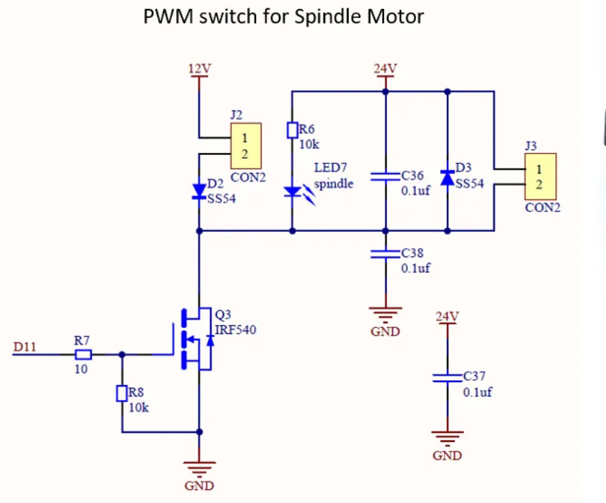

This is the pwm output of my woodpecker grbl controller.
This one looks like d2 is blocking any kind of of external Vcc voltage.
I don’t know a lot of these smaller controllers like you do, so I’ll bow to your statement.
