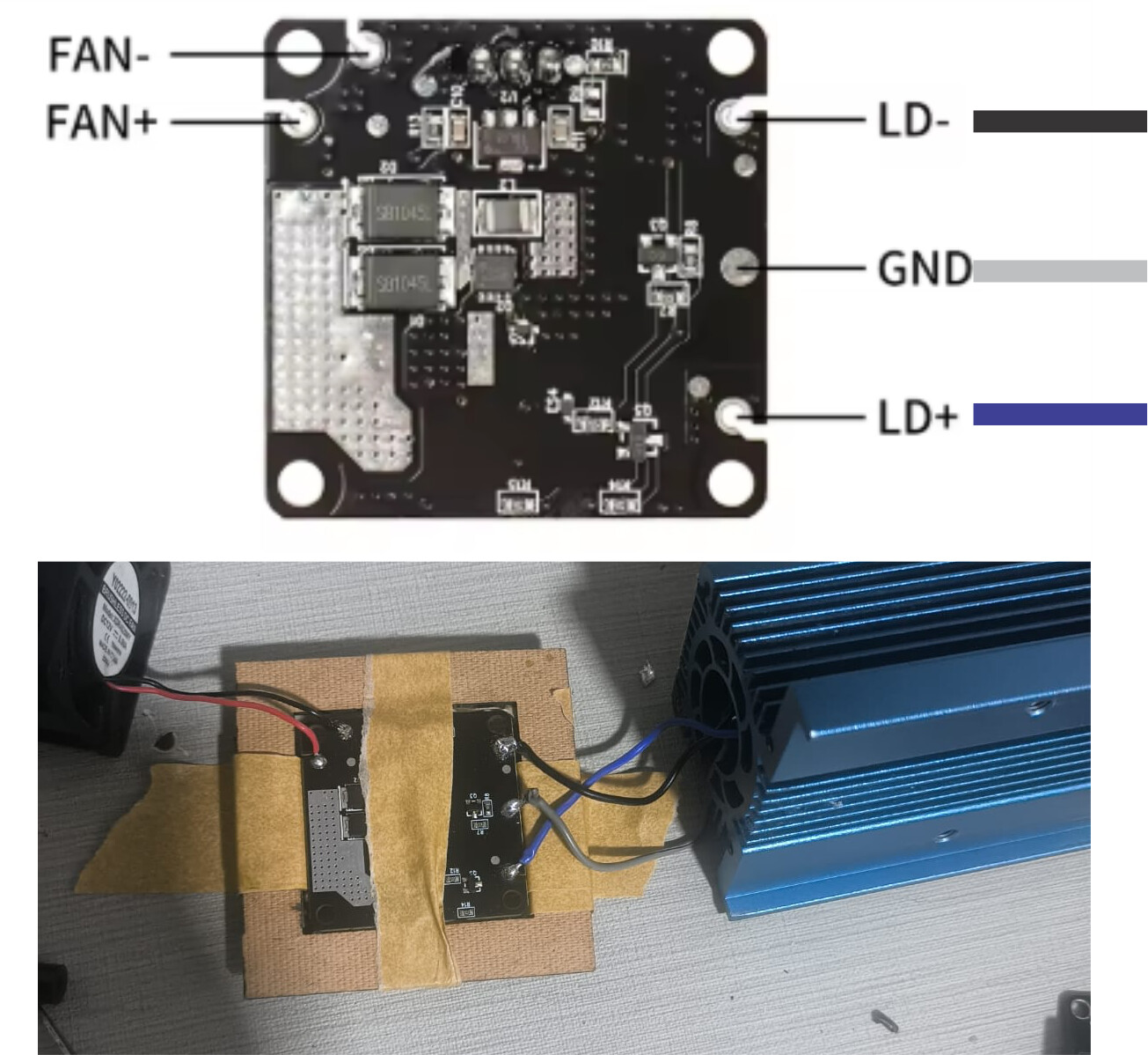

Guys. I’ve been using the Sculpfun S9 for a year. But it stopped working because the module board suffered heavy oxidation and I needed to replace it.
I was told that the LUNYEE 5.5W module board could serve as a replacement for the original Sculpfun S9 board.
But I’m having trouble getting it to work after soldering the cables. When I turn on the machine, the laser flashes every 3 seconds without stopping.
Next, an image of the new board with the cables already in place and an image of the new board according to the specifications in the advertisement:

> [@Arthur\_BR](#):
Maybe they were wrong?
The boards look a bit different, if it’s a good replacement, it should work, but I’d expect it to be similar.
I don’t know where to tell you to start debugging these, as they are usually not user serviceable… If mine failed, I’d try it to, but generally you run into difficulties.
I know how most of these work, generally, but am clueless as to what LD +/- actually mean. Most LED modules have ground, supply voltage and pwm.
I assume there is another board in the body somewhere?

After a few attempts, I finally found the solution.
I’ll explain it here in case anyone else has the same problem.
As I said in the first post, my module’s drive board basically died.
I couldn’t find an original Sculpfun S9, BUT the LUNYEE board (I found it by the title: 5.5W 12V Laser Driver 5V PWM for Laser Engraving Cutting Head Laser Module Engraver Wood Working Tools Accessories) worked for me as a replacement.
At first I thought it was a compatibility issue, but my mistake was the order of the wires.
Here is the position of the cables:
