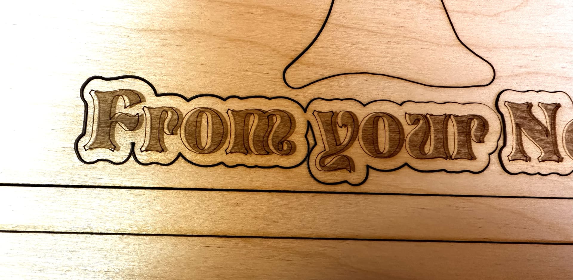

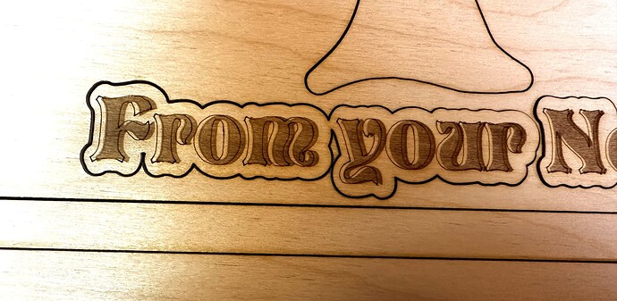

Every time I fill and then line, the line is off by a small amount and as the head moves across the rest of the fill, it gets further and further off. See picture for my example. There is no offset set, my mirrors and lens is clean, everything else runs and cuts perfect, what could cause this? I have a 60w blue and gray.
These aren’t the classic symptoms but I’ve seen cases where what you’re seeing can be explained by the common “PWM Rising Edge” configuration issue for Ruida controllers.
Take a look here for an explanation and remedy and see if it applies to you.
I’d suggest that you take a backup of your machine configuration before making any changes.
Configuring A Ruida - LightBurn Software Documentation
