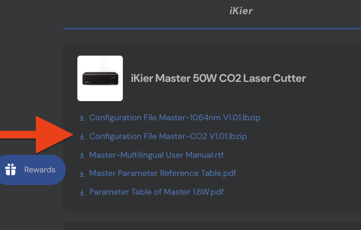

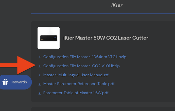

It’s great that the manufacturer has provided a .lbdev file to import into LightBurn’s Devices window, are you using the manufacturer’s settings?
Thanks for the response, and yes. I’m using their included config, have tried updating their firmware as well since I saw an update show up when I tried connecting to their device via their mobile app as well.
