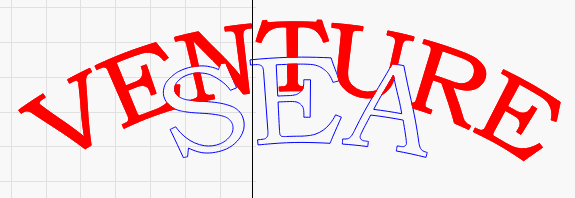

Help with overlap?
jim reitz3.lbrn (22.6 KB)
Ok so I do not want the solid part of venture in the line portion of the word SEA any help on how to do this. Thx
Follow these steps:
  • Select ‘Sea’
  • Press Ctrl+D to duplicate it
  • Select ‘Venture’
  • Shift + Select one of the ‘Sea’ copies
  • Click ‘Boolean Difference’ to subtract the copy of the ‘Sea’ graphic from the Venture
That’s it.
Worth noting: once you do this, the ‘Venture’ text is no longer a text shape, because it’s been modified.
