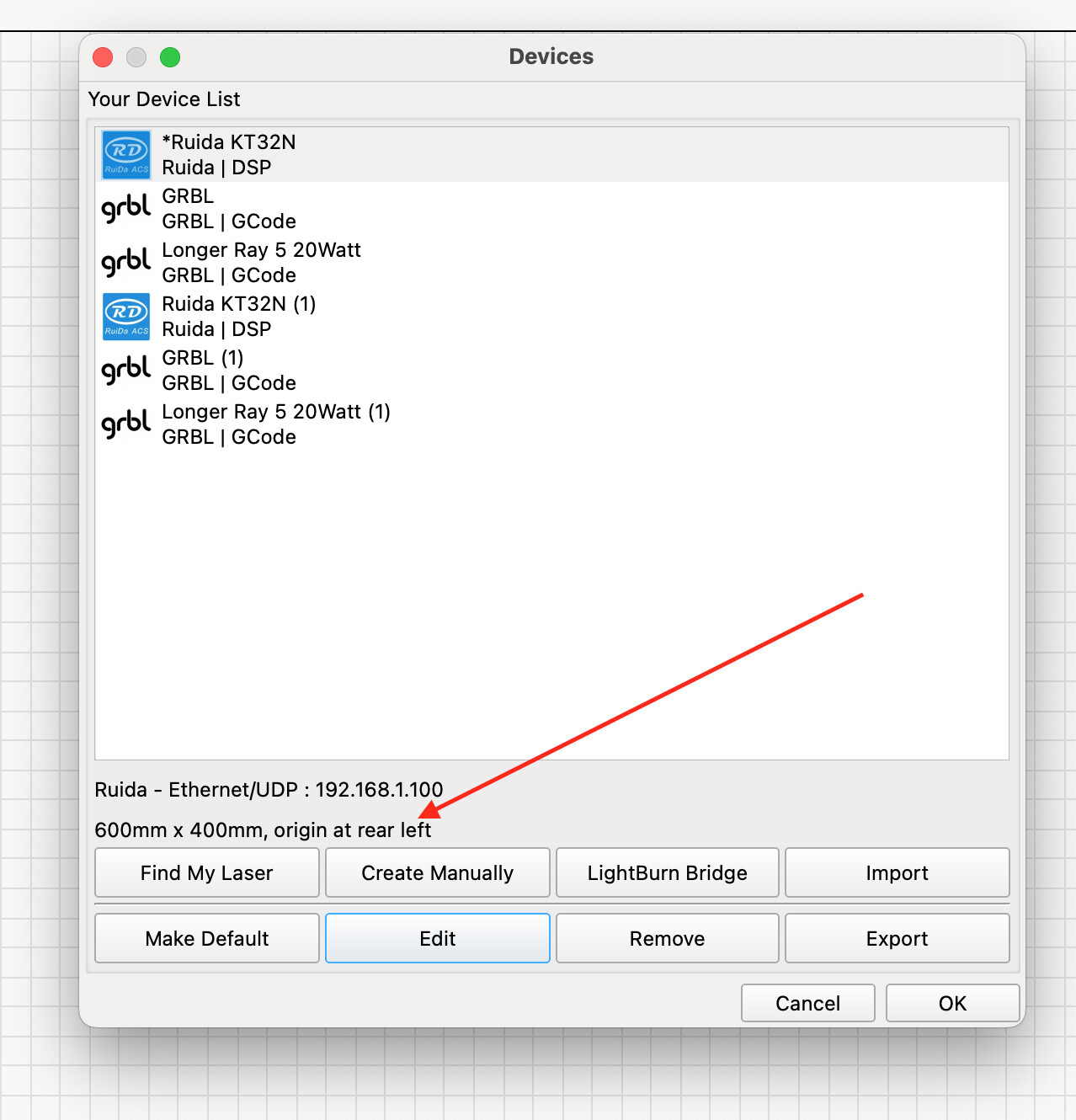

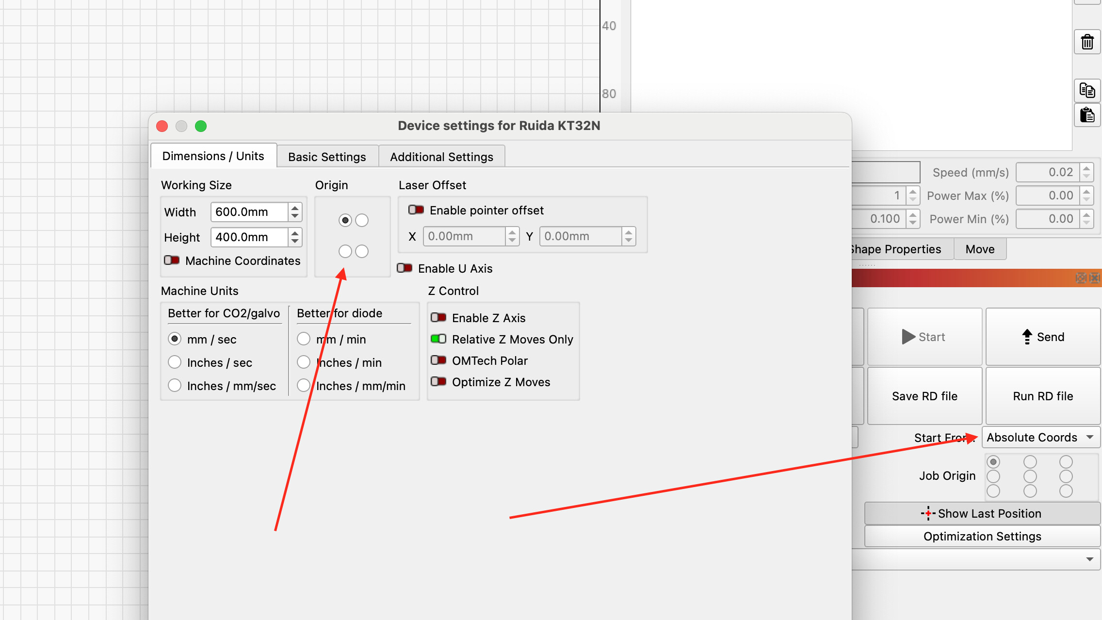

**Author:** ![bernd.dk](https://forum.lightburnsoftware.com/user_avatar/forum.lightburnsoftware.com/bernd.dk/32/125208_2.png) [@bernd.dk](https://forum.lightburnsoftware.com/u/bernd.dk)\
**Post date:** [July 6, 2025, 2:02pm UTC](https://forum.lightburnsoftware.com/t/home-position-changed/174725/2 "2025-07-06T14:02:00Z")
</div>

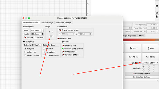

![Skærmbillede 2025-07-06 kl. 15.54.04](https://forum.lightburnsoftware.com/uploads/default/original/3X/f/d/fd0e4c5f58d117db7395291c029380877047d214.jpeg)
 ![Skærmbillede 2025-07-06 kl. 15.56.10](https://forum.lightburnsoftware.com/uploads/default/original/3X/3/4/3407e597dbccfa56d3fa8c142237458e45210b88.jpeg)
Try to see if your settings are different, the setting with absolute coordinates is optional and most use it as standard.

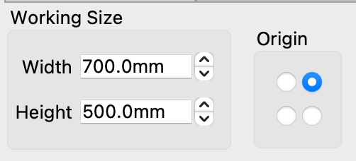

Hi again,
I’m probably really bad at explaining—sorry about that! I don’t have enough experience or knowledge about these things to be very specific, but I’ll try again.
As far as I know, I’ve never changed the home position of the laser, neither in LightBurn (I don’t own RDWorks) nor on the actual laser (I believe this is called the Ruida controller(?)). Image of my controller below:
 ![image](https://forum.lightburnsoftware.com/uploads/default/original/3X/0/3/0355a5c0854ba764455971857a998ae9a879897d.jpeg)
Previously, when I pressed the “Home” button in LightBurn, the laser head would move to the upper **right** corner, perfectly aligned with my honeycomb. The XY coordinates on the Ruida would then show X0, Y0.
Now, when I press the same “Home” button, the machine moves up to the upper **left** corner and doesn’t stop even when it hits the metal frame of the hood. At that point, the head starts bumping against the frame for a few seconds (which doesn’t sound good at all—it feels like it’s trying to move beyond the machine’s limits). Once the head stops moving, if I try to move it along the X-axis back towards the right, the machine only allows the head to reach about the center of the working area. Here the Ruida shows X380, Y0.
So it seems like the new home position is somewhere outside the honeycomb (though physically unreachable), and the machine now thinks the maximum X travel is only to the center of the bed. I really hope that makes sense! 🙂
This has never happened before. I guess it might be due to something I did earlier today when I had alignment issues and pressed “Set default para”. I thought it would re-align everything, but I was clearly wrong…
Here are my settings in LightBurn:
 ![image](https://forum.lightburnsoftware.com/uploads/default/original/3X/5/a/5ae5129ae26b325f6d1850b461f74cdc67c0a670.png)

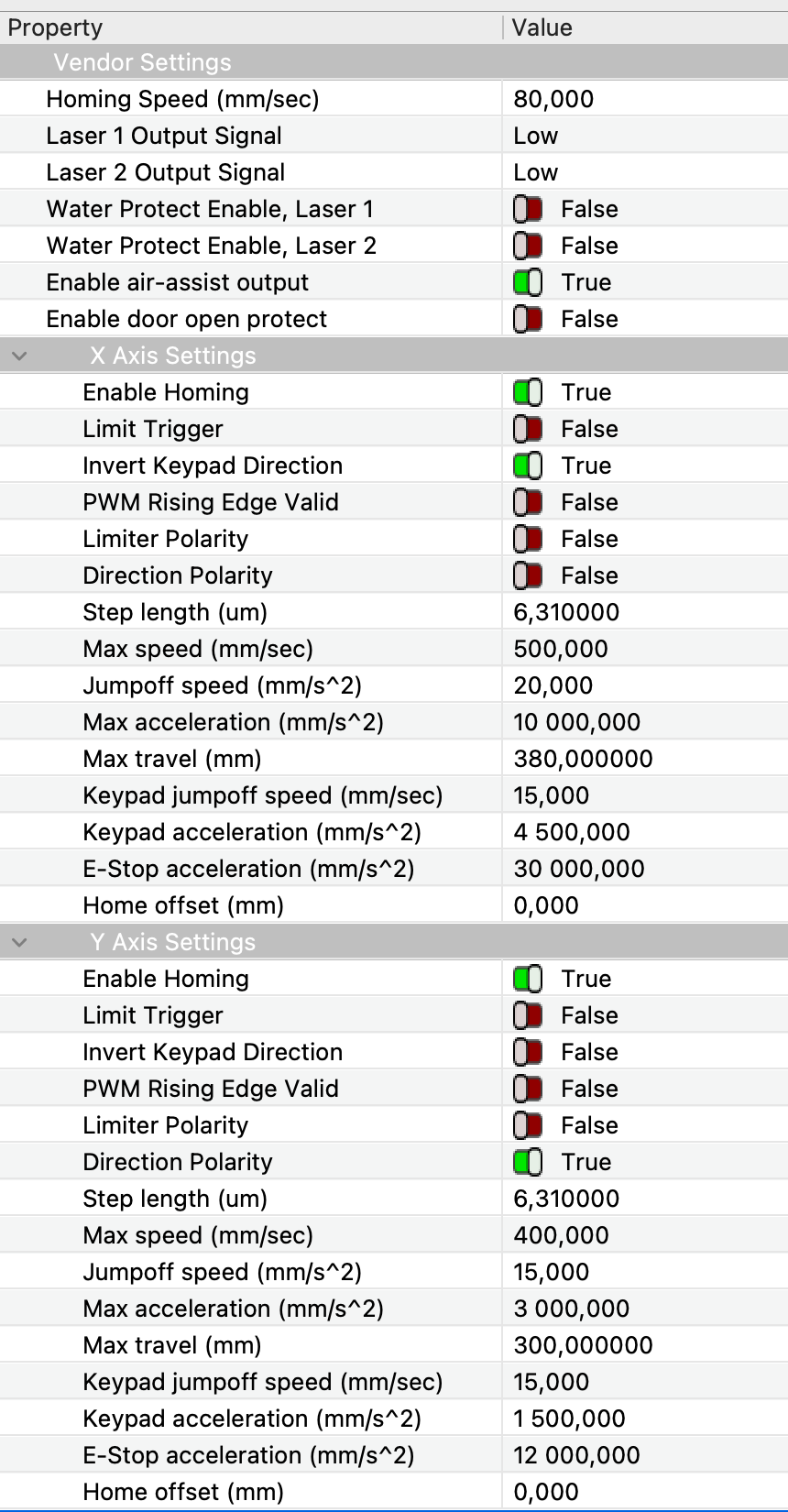

Here are the settings from the machine:
**Mainboard firmware version: RDLC-V8.01.62**
 ![image](https://forum.lightburnsoftware.com/uploads/default/original/3X/f/a/fac4e6aa4e38d9860a386c38d3b7dd08cd5034d0.png)
**I’m so greatful for all your help and support!!!**
Thank you! // martin

As @jkwilborn writes, we need to find out where your (machine) home is, where are your home switches/end switches - top right or top left???

When you start your machine now, does it home to the Right Rear corner? Same question for when you press reset on the controller. Is it only the home button in Lightburn that is giving issue?
A couple things I see that might contribute to your issue. You have “invert Keypad Direction” True on X, False on Y and “Direction Polarity” False on X, True on Y. My machine is False on all of those settings.

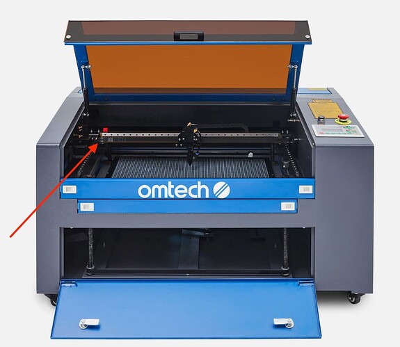

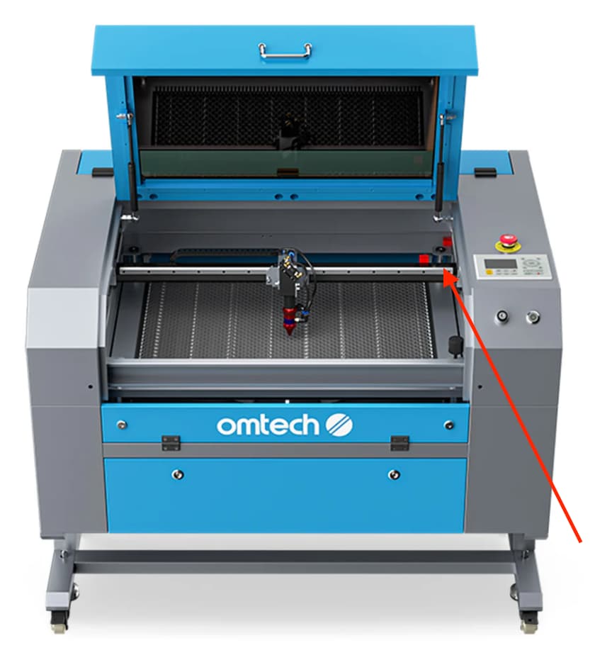

Not sure what the home/end switches are. But, I can see that there’s a small red box located to the rear right which lights up when I go beyond a specific point (which is now possible due to all this fuzz). Make sense?

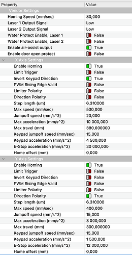

 ![Skærmbillede 2025-07-08 kl. 07.38.51](https://forum.lightburnsoftware.com/uploads/default/original/3X/d/1/d156972b8e46e09ce5b0b1ef2265e3beec419c06.jpeg)
 ![Skærmbillede 2025-07-08 kl. 07.36.02](https://forum.lightburnsoftware.com/uploads/default/original/3X/1/e/1ec216a5731629c92415ee8554e11bd9cf651f16.jpeg)
The content of your last posts indicates that your machine settings do not match the physical machine you have. If it tries to home in the opposite direction of your endstops, then it is the settings, the machine runs in the direction of the endstops, but does not stop, then it indicates a defective endstop.
Find a backup of your machine settings and import it, it should very likely restore your original settings.
You can try to recapitulate what could be the cause of your problem. Have you updated LB, have you proven or unproven changed/tried something in the settings…

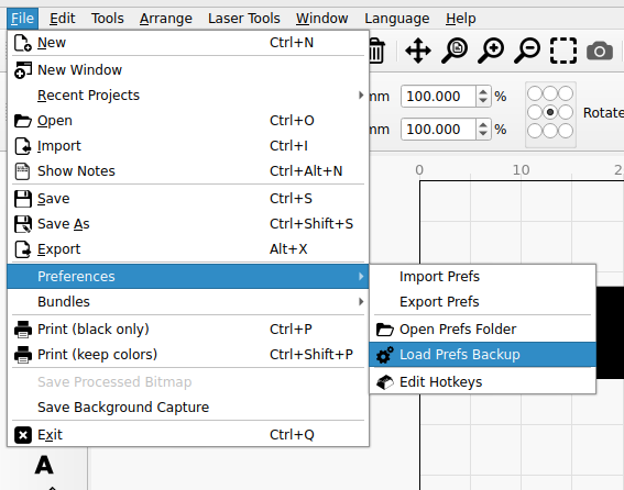

You won’t find it from the vendor. You should have saved a copy of it’s settings on day one. Just to ensure you have these.
> [@Styret](#):
> upgraded (Via RDWorks) hade the home rear left
You don’t get to pick the home corner.
Might try this and see if it helps. I’m running an older 1.7.04 version.
 ![image](https://forum.lightburnsoftware.com/uploads/default/original/3X/5/d/5da4923b4432a170262a2cc12edbf09e2a7e1ca6.png)
<div class="post-metadata">
**Author:** ![Styret](https://forum.lightburnsoftware.com/letter_avatar_proxy/v4/letter/s/5f8ce5/32.png) [@Styret](https://forum.lightburnsoftware.com/u/Styret)\
**Post date:** [July 25, 2025, 4:03pm UTC](https://forum.lightburnsoftware.com/t/home-position-changed/174725/19 "2025-07-25T16:03:37Z")
</div>
Bummer, I didn’t know that I was suppose to backup the machine file. Lesson learned. Somehow I’ve managed to get the machine to recognize that the upper rear is home, so halfway there. I think it was thanks to the file I downloaded in combination with what you just wrote.
Now the machine starts at the correct position, but will still travel too far on the X axis and too short on the Y axis. It’s almost like the distances has been switched somehow. When I reach 500mm (Y’s max i 500mm) I’m maybe 3/4ths of the honey comb. The X axis is around 500 when I reach the rear left corner. How can I switch these?
Many many thanks!
