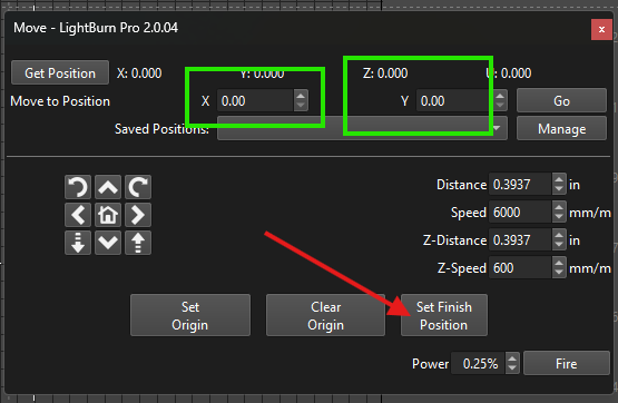

Hi
Just need some help how do I setup in light burn when I finish cutting the Laser Module goes to home position left hand top hand not left hand bottom.

Open your MOVE window. Set your desired landing coords in the windows for X and Y
Then click on SET FINISH POSITION
 ![image](https://forum.lightburnsoftware.com/uploads/default/original/3X/f/c/fc1f3a926dd552252f19a35c9d598789e6331ade.png)
