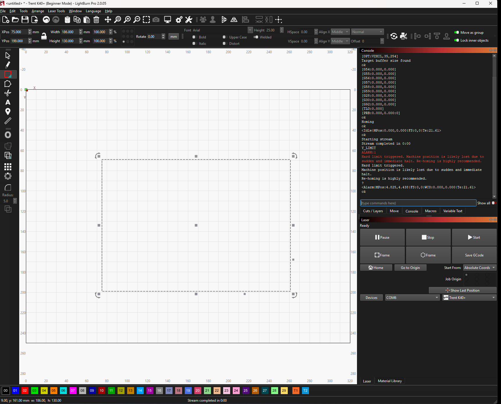

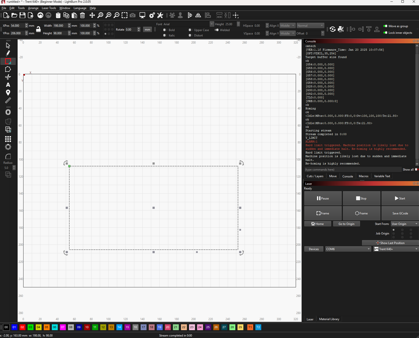

So working through the Alarms and Errors. I placed a box in Lightburn and clicked frame. This is what I get. Also if I choose to unlock $X and click frame again the laser tries to move back further which causes the laser to make a loud noise. Assuming its trying to move beyond its limits, I click stop.
Switch from User Origin to Absolute Coords. Then the laser will go where the drawing is placed.
Once this happens, the controller does not know where the laser module is located. You must use the Home button again.
I have switched to Absolute Coords and I am still running into Alarm:1. Clicking home seems to work. But when I click frame, I get Alarm 1 again.
Then you have an issue with the limit switches itself. One of them gets triggered during motion. Alarm 1 tells that. Check if all cables are ok. You can test by moving the head somewhere to the center and then send the question mark command (?). Post the output.
Moved the laser to approx. center and took the screenshot.
Returns to home just fine when I click home.
