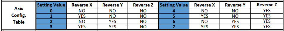

i have a maxaprin lc400 pro (cheap beginner), the homing switch for x is in the bottom left. when we turn on the lazer it tryes to home to the bottom right side. i have tryed to change the home position on setup in all 4 locations and not been able to find how to set home. any information is helpfull!
The actual home direction is controlled in the firmware settings on the laser and not in LightBurn.
Please go to the console and type $$, then enter. see the value $23=??
The direction chart is as follows
got that fixed and will home out in the right corner and also have adjusted the $27 so it will home out correctly. now it seems that home is -399 instead of 0, also on the screen it is out of bounds.

You may have a machine offset type $# into the console and see the results.
If you see a negative offset you may erase it with $RST=#
