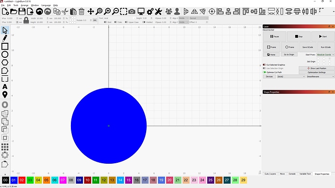

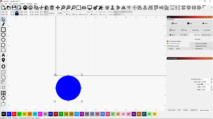

Hi guys,When i move an object to 0x 0y the top left of the object is at 0,0… is it possible to have the center of the object to be moved to 0,0 just by punching in 0 x 0y into the coordinates? am i missing an option somewhere to change this?.
Sorry everybody of course within 5 mins of posting i figure it out LOL for anybody who needs to know its the 9 circles next to the scale numbers just select the center one.
Yep, you are correct. image :slight_smile:
