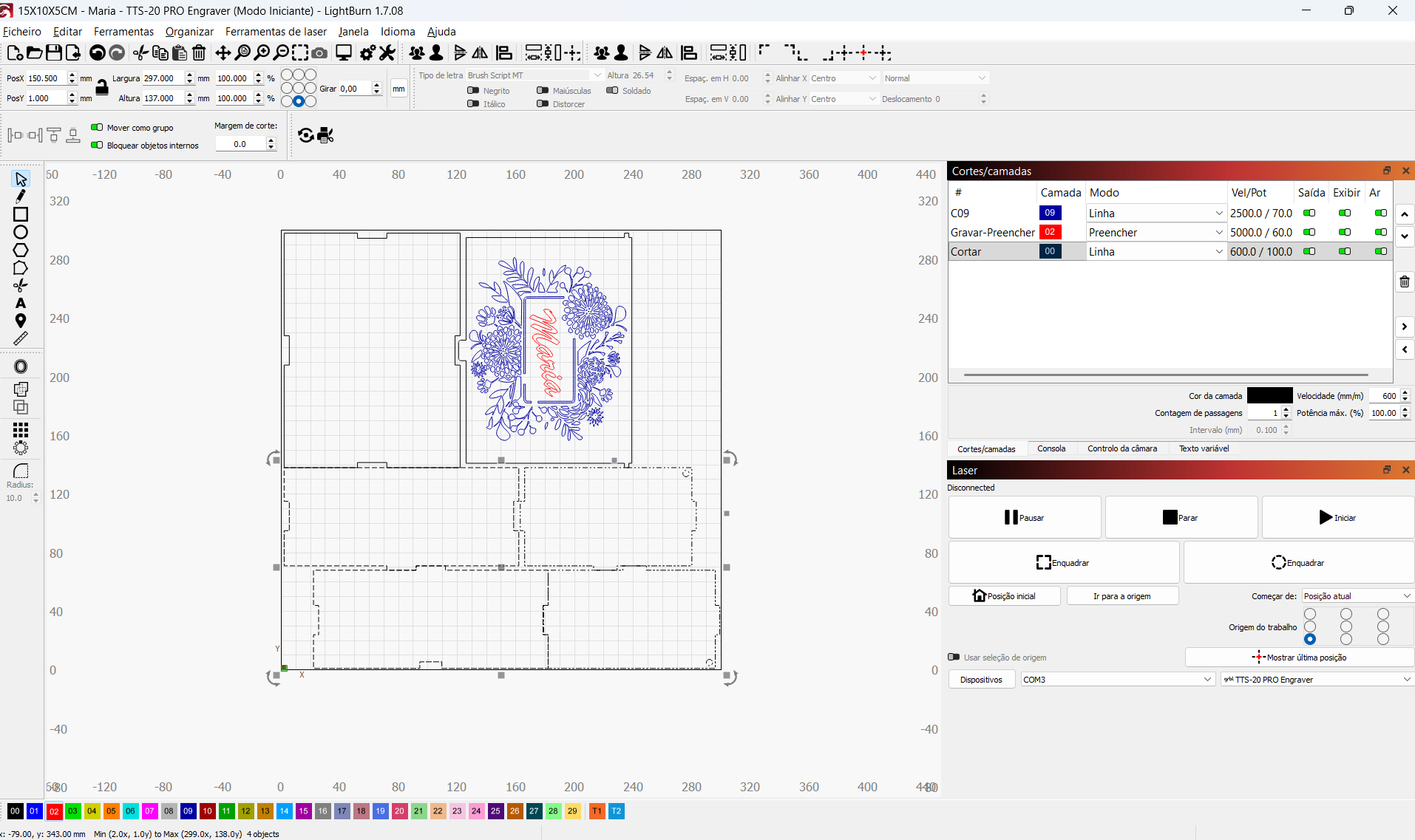

Hello. My TTS10 machine cuts 300x300mm. I would like to use LightBurn to cut only what is within the selected workspace, ignoring what is outside and not selected. A few years ago I opened a post here with a similar question, they helped me and I was able to use it. Now I had to change computers and I’m not able to adjust this in the new installation. I’m using version 1.7.
Previous post: [How to cut only what is inside the desktop?](https://forum.lightburnsoftware.com/t/how-to-cut-only-what-is-inside-the-desktop/134861)

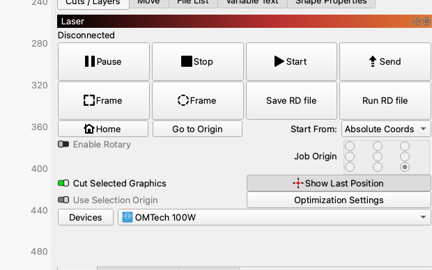

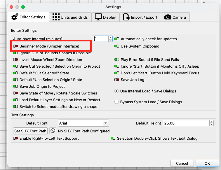

First, uncheck Beginner Mode in the Settings Menu (gears icon)
 ![Screenshot 2026-04-10 at 12.28.18 PM](https://forum.lightburnsoftware.com/uploads/default/original/3X/3/4/34c25cffde1de513f5a6365380aa21a54af09697.png)
Then you will have Cut Selected Graphics available in the laser window.
 ![Screenshot 2026-04-10 at 12.29.52 PM](https://forum.lightburnsoftware.com/uploads/default/original/3X/f/e/fe3261352325b33561aae31fe9f4bc23fa31975f.png)

Thank you very much, that solved the problem.
