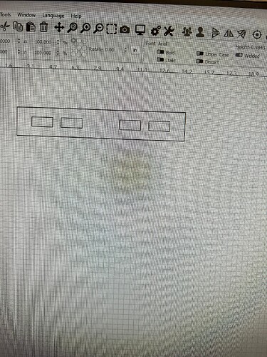

I am struggling to evenly space several objects within a frame

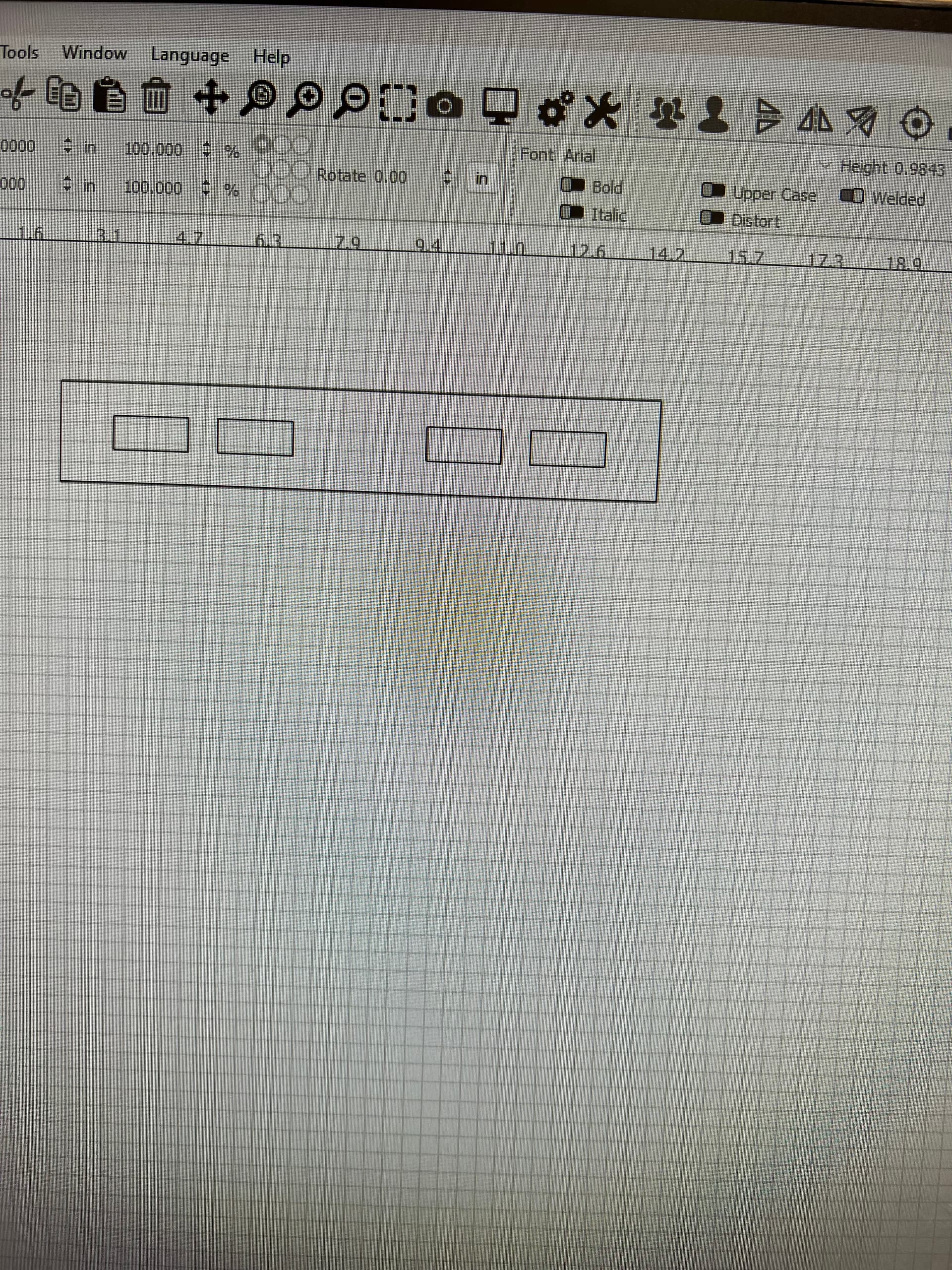

I must be doing something wrong; I can select say five squares inside a rectangle (the rectangle is also selected) and evenly space them horizontally, but it will not evenly space them verticaly
Post a screen capture so we can see what is happening.
I am fairly new at this, I don’t even know how to do a screen shot other than with my Iphone!

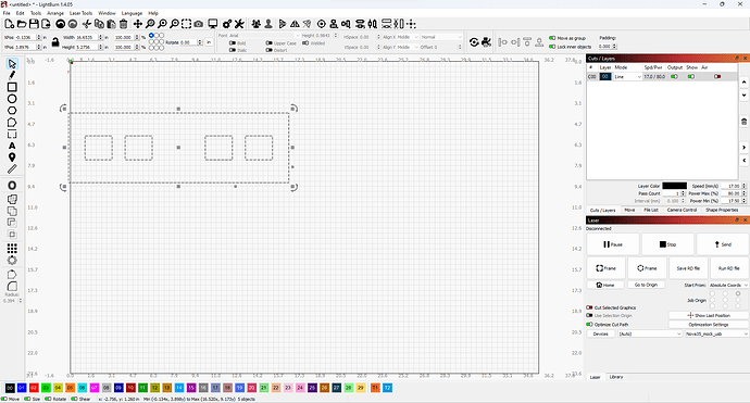

Thanks for the tip. this is what I get when I try to equally space vertically
they are not
Try horizontal.
Vertical should work. It does for me.
It does only if I select the objects within the frame, but then the left and right spaces aren’t the same as the others.If I select the frame and the boxes inside the frame, I get even spaces left and right, but larger space in the center.

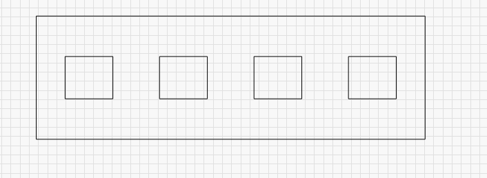

Ok, select the inside and space them. Then group those 4. Then select everything and use the bulls eye to centre everything.
Great!, thanks for your help!
