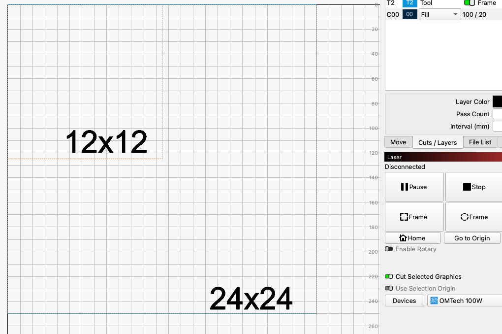

I have a OneFinity Elite 48" x 48" Masso. If I use a 12" x 12" piece of material for one job and a 24" x 24" on another job, is there a way to keep the page size with each job as assigned? I realize I can set it to 48" x 48" and leave it set to that size but that is a real pain when using smaller size material with many layers that I need to place outside of the 48" x 48". Hope this make sense to someone. Thanks
I think I understand your question. I would create tool layers for each of the material sizes and place them on the work area where you would cut. I assume you have a fence system in place for positioning.
You can turn the tool layer on and off as needed for positioning your work. You can have other graphics on the work bed without causing issue IF you use the ‘cut selected graphics’ toggle. Then you select what you want to engrave before sending it to the laser and everything else is ignored.
If you right-click on the output header you can do some other options you can apply.
I use this all the time for very similar operations.
