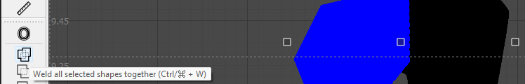

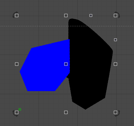

Step 1 - close the first shape
Use Boolean tools to meld the two shapes into one:

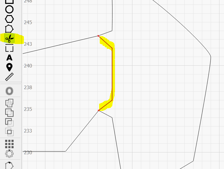

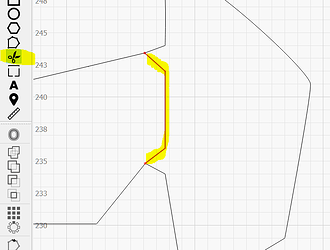

You can use the Trim Shapes Tool and remove the highlighted line.
