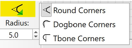

This one? It’s in the lower left.
 ![grafik](https://forum.lightburnsoftware.com/uploads/default/original/3X/7/a/7a3dd921fe2e77f68250379f37e698155504ed7f.png)

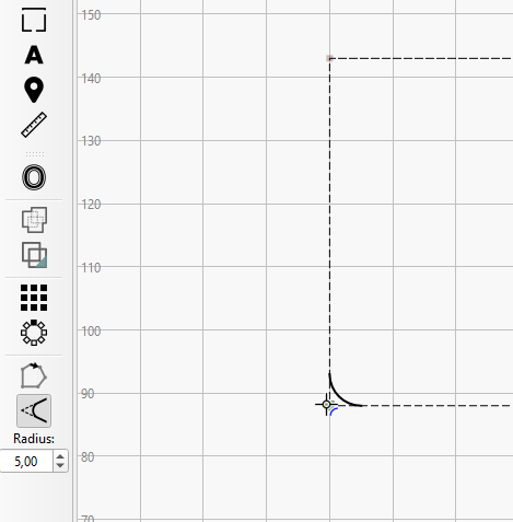

Are you searching for the Dogbone or Tbone:
 ![image](https://forum.lightburnsoftware.com/uploads/default/original/3X/b/e/be4aee7edcaf63f1d17f9b642367fb38d9b99649.png)

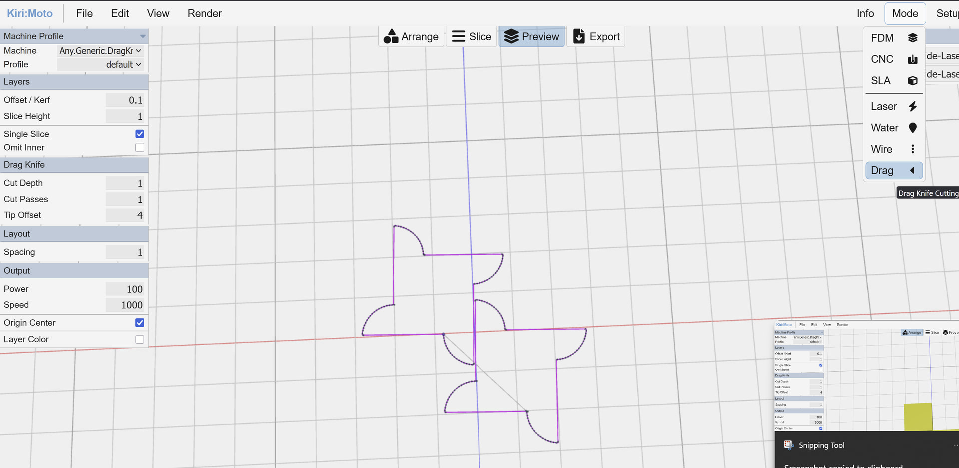

Swivel moves at corners will definitely be necessary for pivoting drag knives and plasma to ensure the drag knife blade remains properly aligned throughout the cut.
Kirimoto also offers this:
 ![image](https://forum.lightburnsoftware.com/uploads/default/original/3X/e/d/edb512c9dedce4410b1e12451d4a705080ece1f7.jpeg)
