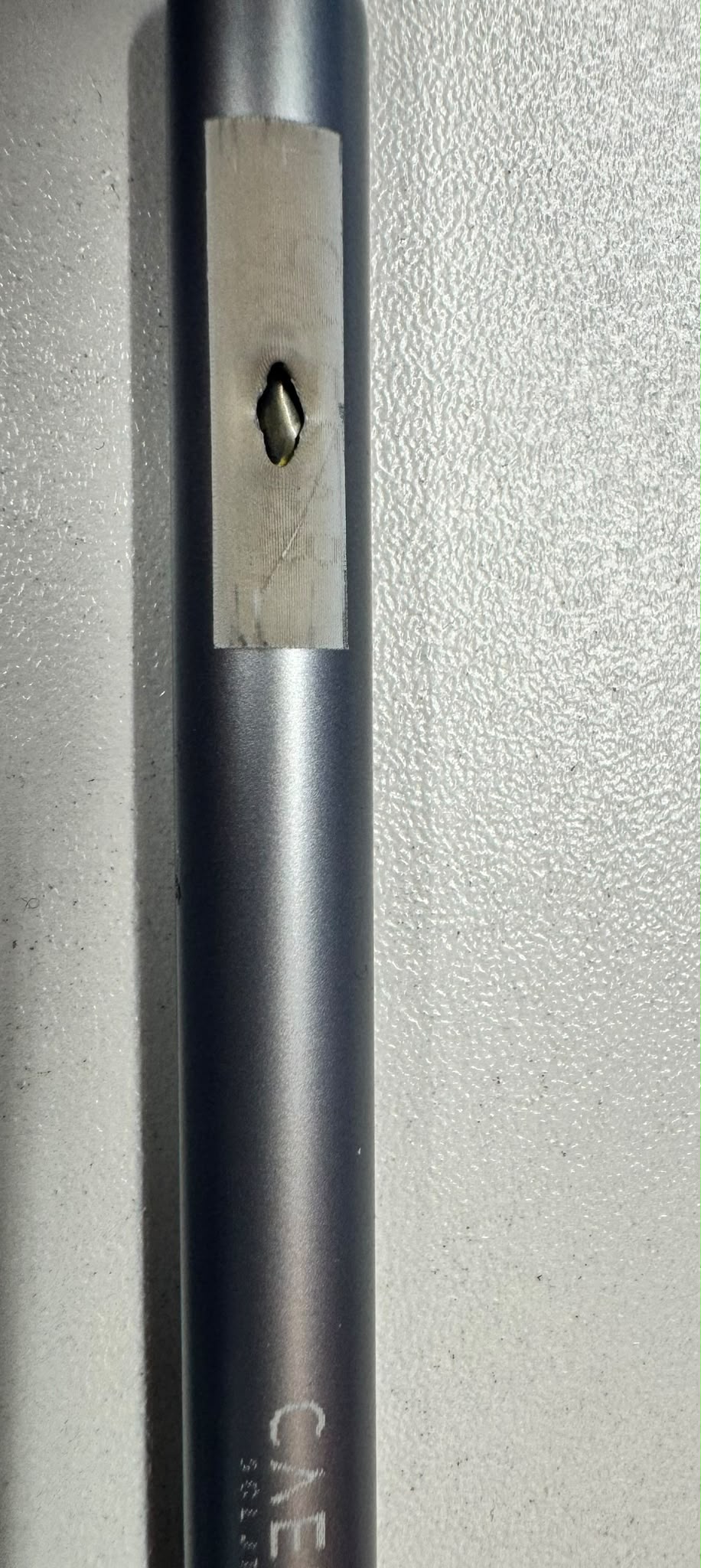

Hi Fins, please consider below sample (Lenovo Tab Pen Plus) closest to the artikle:

Hi Mikey,
Thanks for always responding. Just to clarify one point that currently article does not have engraving bubt marking and, I guess, it can be engraved for the first time (if it can be cleaned / masked somehow). I thought to explain it as I understood from your comment that may be I mentioned about already engraved articles. [quote=“MikeyH, post:3, topic:191363”]
Laser engraving anodized aluminum is a One-and-Done deal.
[/quote]
You can check Lenovo Tab Pen Plus as sample as it is similar material and has marking ‘Lenovo’ in white on grey anodized aluminium. Hope there is some idea to complete it before holidays…fingers crossed!
Thanks

That white writing is likely paint. Grey over aluminum would not give you white. I
Are you sure it is aluminum? The button on the side suggests it is plastic instead. I have one like it (black plastic) for my Samsung phone. If you have one, make a tiny scrape at the top to see what is under the grey.
For a tiny font, you might try the SHX line fonts, like ISO9. Windows also has some line fonts with the standard install.

I have to agree with them on most points.
You can create white on aluminum. This is black iodized as far as I can tell, don’t know how you could create black aluminum.

Hey Mikey,
I rubbed the surface on bottom and top and it is being rubbed fast like plastic. Even ChatGPT is confirming that it is plastic, at least outer body. Now does it change your idea of using fonts? I was planning to use an image with my text to overwrite it in one go. What do you say?

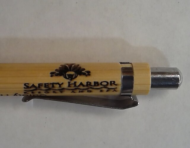

> [@aasrz](#):
My suggestion for the font was based on the size of the pen. The image below is an 11mm diameter pen, much larger than yours. It was also done with a 10w diode (Sculpfun iCube) and no rotary. I had a lot more area for my logo than you have.
My stylus pen is 6.75 diameter with about 5mm of flat area on each side. The hilight along the center of yours indicates it is round without any flat surfaces. I would guess a max of 3mm working width without a rotary, and 5mm with one. If you try to wrap the text or logo too far around, it will be visually unappealing. You look at a pen, but rotate a glass or mug.
 ![2026-07-24-090415](https://forum.lightburnsoftware.com/uploads/default/original/3X/a/a/aa22e8ddac16bc563783f836adef865cfe7b9ebc.jpeg)

> [@aasrz](#):
> What are your settings for above markings?
That is bamboo, so my settings would be meaningless in your application.

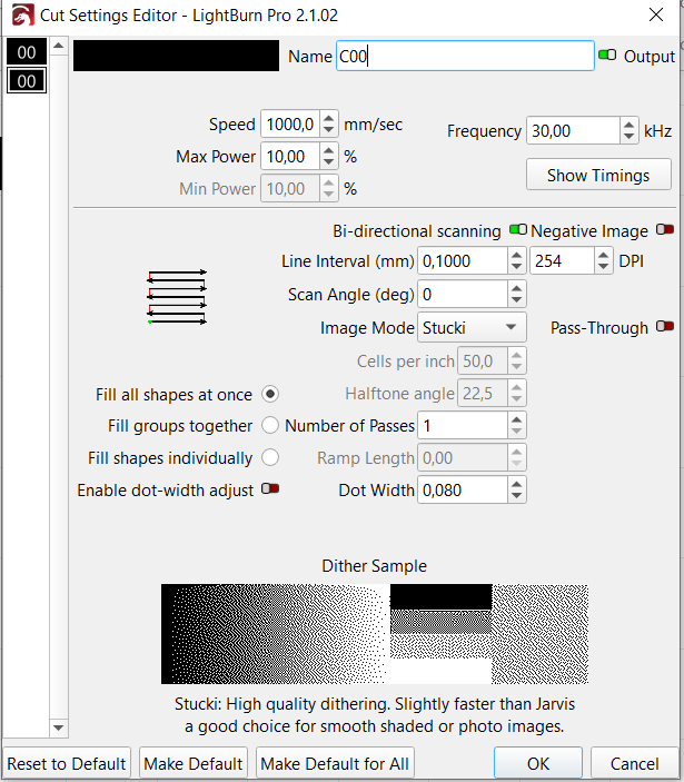

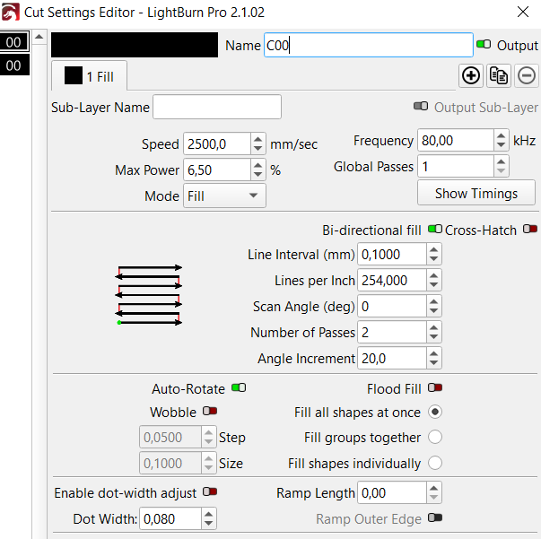

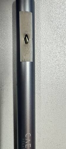

Hi, Good Day!
My plan was to make white rectangle to hide existing writing and then write a logo on that white rectangle. However, could not figure out how to write in black as monport laser is still marking in white. Below are settings for making white rectangle and marking logo. Logo otherwise marking fine on grey cover (see attached pics: I was also testing limits for making white rectangle so burned it in the process therefore plz ignore burned issue).
1. Settings for makink white rectangle to hide existing text:
2. Settings for marking image logo (which works fine on grey but need suggestions to make it black)
3. Test Results
Thanks in advance,
AZ

> [@jkwilborn](#):
> what kind of a machine you have
You need to help us help you. Your machine/power/lens isn’t mentioned in either your profile or in the post.
I know it’s am OMTech, so it could be about anything. The settings appear to be something only a fiber has.
Suggest you update your profile (_ **License Management → Update Forum Profile** _).
 ![image](https://forum.lightburnsoftware.com/uploads/default/original/3X/9/e/9e295a015d949b2e49606b057ed2cb6f20acb8fd.png)
When someone _ **posts a question to you** _, when trying to help you, it’s only simple courteous to answer their questions.
Specifically you need to tell us what kind of material it is. If you don’t know, we have our hands tied and likely can’t help you as much as we’d like.
All I can tell you is that for a fiber, you can usually use a much smaller interval. However, it adds more heat, which appears you don’t need as your material appears melted. With a fiber you can melt some metals.
If you’re attaining white, it appears to be working from your description. You might not be able to obtain black at all. It depends on the type of material.
Can you convert your ‘image’ to a vector? Might simplify things.

> [@aasrz](#):
So you wanted to burn it white, then burn it black with the same material and machine? It does not work that way unless you are using laminated with various colors.
Laser has 2 colors, burned and not burned.
