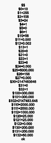

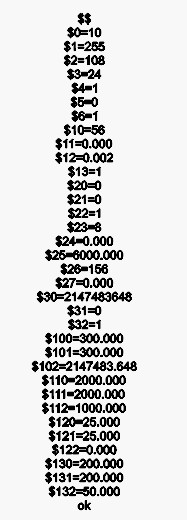

A list of the GRBL $# and $$ settings will be helpful.

I will get $$ values shortly…I am wondering if it could be a faulty control board.?

Almost certainly not, because such problem are generally due to a misconfiguration.
And the GRBL settings have major problems:
  • $11 should not be zero, as that allows no wiggle room while curve following.
  • $20 must not be zero, as that prevents the controller from detecting out-of-limit commands
  • $24 must not be zero, as the homing cycle will be unable to complete. Perhaps 100 mm/min will work better.
  • $25 seems very high. It exceeds the $110/111 values and can never be reached
  • $27 must not be zero, as that prevents the homing cycle from pulling away from the switches
  • $30 is absurd. It should be 256 for the Arduino-class controllers typical for 3018 machines, with LightBurn’s S-value max set to match
  • $102 cannot possibly be correct
  • $120 and $121 seem very low, even for a leadscrew CNC machine, and $122 being zero will prevent the Z axis from homing
  • $130 and $131 do not match the physical size of a 3018 machine
Based on those values, I do not see how the machine could home correctly, which would explain problems with jogging or any motion at all.
So the first step is to correct those settings.
Then the $# values are likely incorrect for LightBurn, so check those, too.
