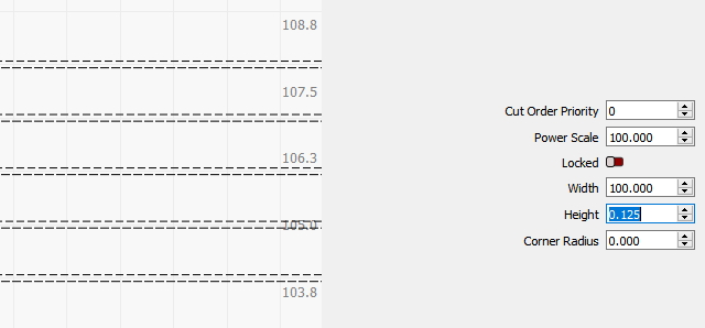

You don’t have to resort to text editing for that - The ‘Width’ and ‘Height’ of the rectangle are shape properties, and can be edited in the Shape Properties pane in LightBurn - you can even edit many at once. This will size them from their individual centers, like this:

I think this is what I am looking for. When I said component I was referring to a program called sketchup which allows you to create a “component” if you had 100 of those components well say like fence posts and you wanted to change them from 4 feet to 5 feet you only change 1 and the other 99 are changed accordingly. What I am doing here is a simple box being made from various thicknesses of cardboard. If I change the thickness the box inserts will need to be made bigger or smaller based on the size of the cardboard being cut. My slider box has 16 cutouts that would need to match the thickness of the cardboard being cut so being able to make them into a component would allow me to change 1 and the other 15 are changed. When I select all 16 cutouts and go to the shape tab I don’t see anything below the “Locked” button. I don’t see Width, Height or Corner Radius. I am using the DSP version 1.0.06.
Width and height options would only be available if the objects were still rectangles created in LightBurn. If it has been converted to a shape or imported from another tool those controls would not exist.
You can still scale the size using the numeric controls with any shape.
This is what I am doing is resizing by turning off the lock so I can just get the thickness to change. Just trying to save time by only touching 1 instead of 16 shapes. The shape property box would have worked but they are not rectangles created in Lightburn. They are SVG’s brought in from another program. So it looks like this may be a feature request?

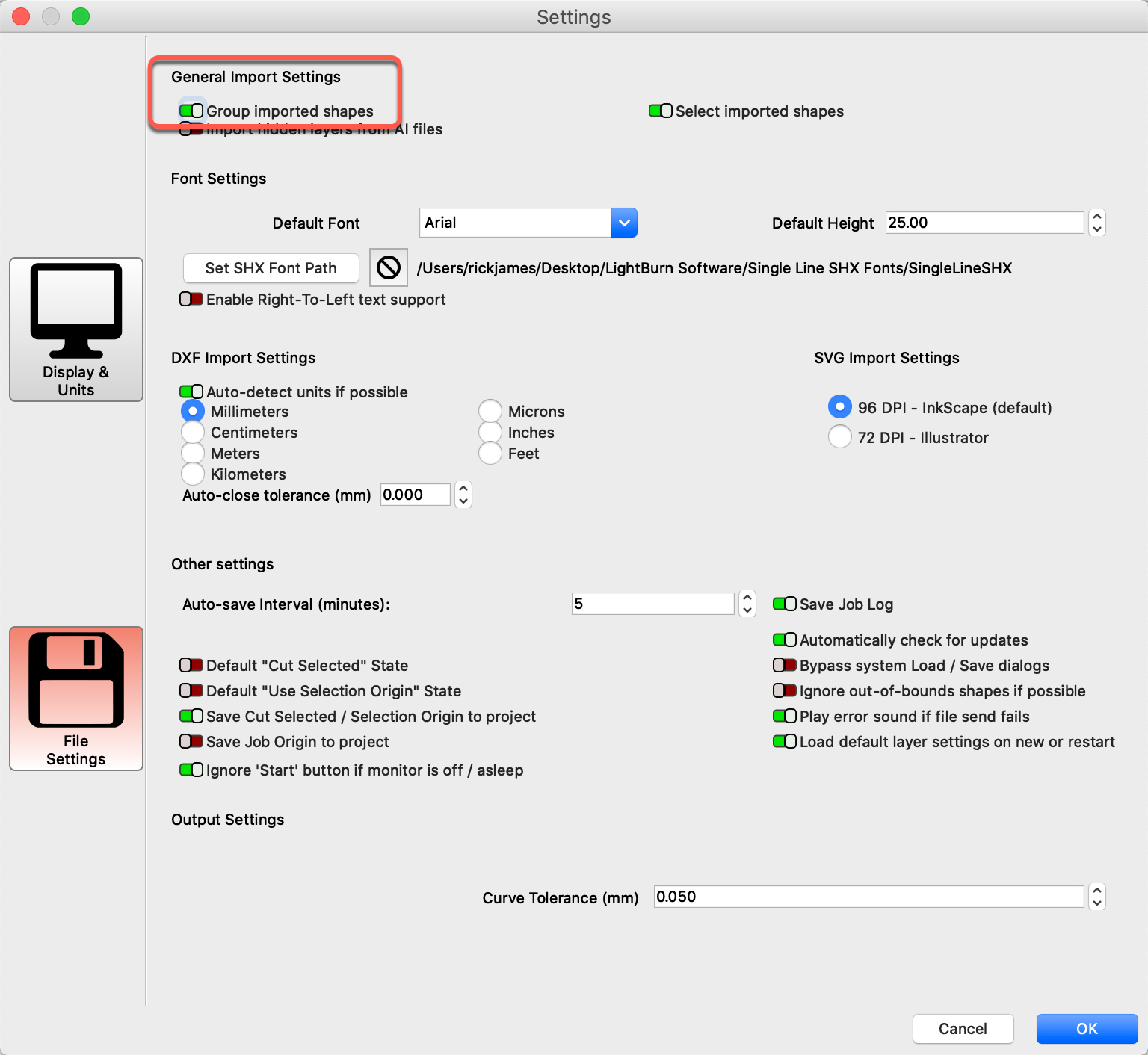

When I tested it for a rectangle it lost the shape information. This is interesting since its preserved within Inkscape. That would mean Inkscape is copying two forms of the shape to the clipboard and only making one available outside the application…
Thanks. That worked for me. I didn’t even consider it because I had only copied and pasted a single rectangle. Didn’t occur to me that it would be a group of 1 object.
If one has it set to, it will. :slight_smile:
