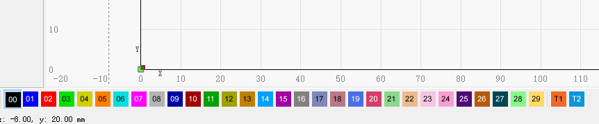

How to customize colors
Our product requires a lot of colors and we need to mark each color with a corresponding color and use different power and speed for different colors. I found that the color markers provided in the software are very limited and there is no white color. How do I need to go about adding custom colors
You cannot change the colors in LB. They are hard coded.
Hopefully the software engineers, will include a white color block in the next update?
I’ll bet a while line on the white screen is going to be impossible to see. A white fill isn’t going to be much better, unless the background is black, but then one cannot see the black items nor the grid.
Let me state I’m not on the Lightburn staff and I don’t know the internals of how their software functions. However you do pick up a few things about how it likely works. Add to that, I start getting confused about what’s happening with only 10 layers.
I’ve used software like this where the color identifies the operation.
Lightburn does not operate like this.
Color in Lightburn corresponds to a layer, not an operation. Within the layer you can change the speed/power and many other things. There is a library function where you can store and assign data to a layer.
I believe the architecture of the Lightburn software precludes doing what you are requesting.

At the top right of your browser is Feature Suggestions. Post it there and users vote on it.
Even though all the wise things have been said about colors and their function
I see the question as a consequence of @xuzhuqi not understanding the very basic principle of LightBurn’s layer system. We already use layers in this way as @xuzhuqi wants. These are our tools with the properties we have assigned to them. Red is the cutting torch, which many use exclusively for cut operations, black is for example writing
etc.
This in combination with the sub-layer option gives a very large number of “tools”, which I cannot imagine not being able to cover one’s needs.
NB. White color on a white background is not a good idea :wink:

Lightburn has a “dark background”, but it isn’t a true RGB black. This allows LB to also use RGB 0 0 0 (black) for Layer 00 with a dark background.
I am well aware that the colors and placement can be changed for layers in LB, but that is not what @xuzhuqi asked about in his initial request.
The op asked for custom colors in LB. LB colors are hard coded, and cannot be remapped
I must have misinterpreted this link:
Sorry
I think you are mostly correct. You can reorder the default LB colors with the json file. But, the json file does not let you use non Lightburn RGB colors.
