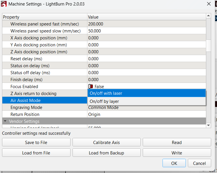

How to enable process blow In the air assist tab in lightburn
Hello, I am new to forums. I will do my best to get the things you guys need to help. I have a blue elephant laser 1500x3000mm ELE1530 laser Rudia 6445-g controller. Lightburn pro 2.0.03 window 11 laptop ASUS Ryzen 7 processor. As far as cutting and engraving that all work great. The issue is when I engrave the air assist rapidly triggered on and off from what I understand it need to be changed to process blow and there is not a option for thar in Lightburn. Please help!
You probably want on/off by layer. On/off with laser will only turn on when the machine is lasing.
Hello, I have it currently set on/off by with laser. I guess the screen shot doesn’t show that though. Thanks anyway.
