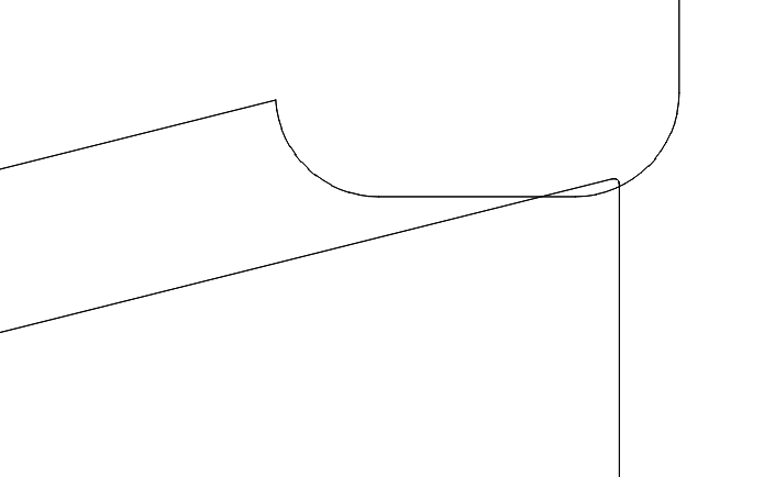

If I try to use docking to nest my objects close together, while also using kerf offset, I end up with overlap.
Are these two features not compatible with each other?
Can’t you give it a value in “Padding”?
Kerf is normal under a tenth of mm, so with 0.5mm in padding it should be ok.
PS. Is it in the preview window or when you cut it out?
Oh my goodness … I hadn’t found that option until you mentioned it. I will give it a try - thanks!!
