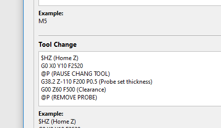

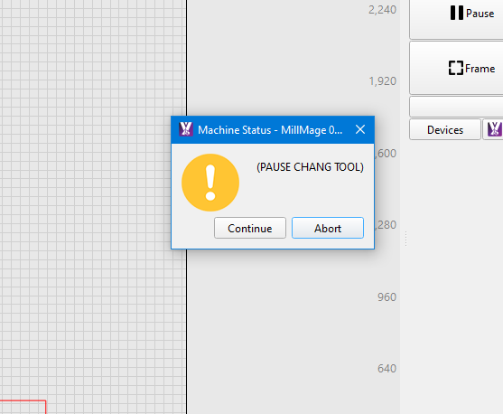

that video has helped with my tool change issue changed M0
to @P tool changes work great now
 ![TOOL CHANGE](https://forum.lightburnsoftware.com/uploads/default/original/3X/a/c/ac7e21ed535801224928d7254606180ff55dd400.png)
 ![pause](https://forum.lightburnsoftware.com/uploads/default/original/3X/8/3/83d1f292bb29eb77eec716277d5d4f6f4e7624d6.png)
your guys support is awesome , cant wait for more updates
keep up the awesome work

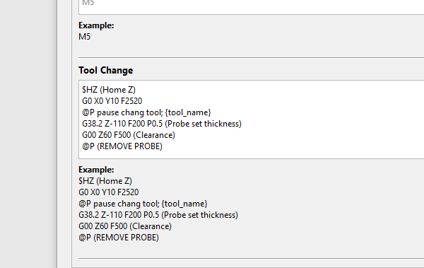

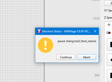

at 3.10m where you type in tool name i dont get that coming up
 ![tool](https://forum.lightburnsoftware.com/uploads/default/original/3X/c/b/cb6c1a5dae2d1f8b73fa42770ced18e2a6057637.png)
 ![Capture tool](https://forum.lightburnsoftware.com/uploads/default/original/3X/9/4/94716d3e63e61a749479ce8dd6137154ca43cdd7.png)
is my test correct ?
