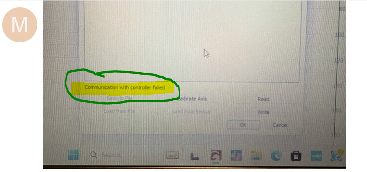

Hi, I have a monport K 40 with the upgraded controller, lightburn ready using Grbl 1.1. I backed up my machine settings and due to my laser not wanting to burn for the material test, I entered the setting that were listed in the machine settings docs. Once that was done, my laser no longer would home and kept hitting the front of the laser bed. I tried to reload my saved settings and it will not load. I have tried to enter previous settings manually in the controller and they won’t save. I then tried to reset the machine settings to default settings per docs by deleting the files in the preference folder. Now there is nothing for machine settings. I enter $$ in the controller and get nothing. When I open the machine settings via edit tab there is nothing listed anymore to edit. It appears I have deleted everything involving machine settings and do not know where to go from here, as the controller will not save manually entered commands.

You cannot delete them, you can only change them (if your controller permits it). You did not break it.

Because your machine wasn’t connected in the “Machine settings” screen.

When you access the Machine settings window Lightburn wasn´t connected to the laser and so the window is blank.

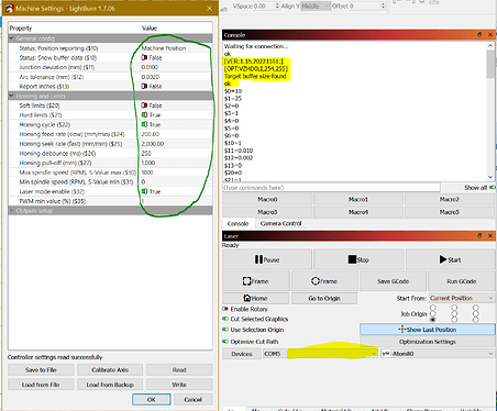

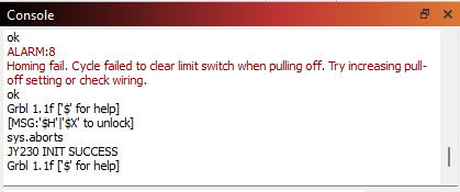

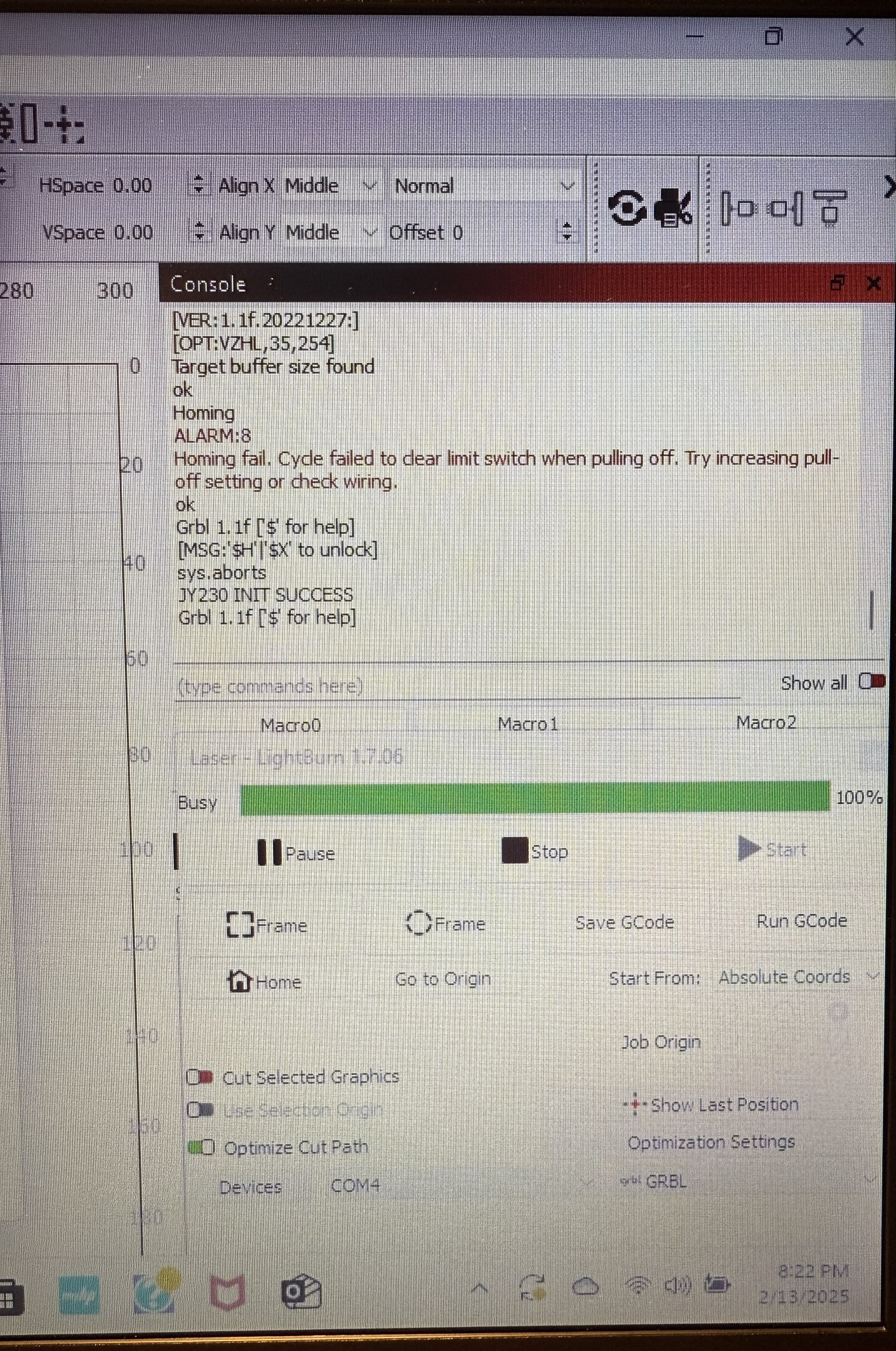

OMG!! Thank you Jesus and FerAS!! I have attached the screen shot of my machine settings as well as the console. I tried to home the laser and I am still getting the Alarm 8. I would greatly appreciate input on start out settings for material testing acrylic. That is all I want to do is cut acrylic, 1mm-3mm. Is that too much to ask of my laser? haha. I’m not difficult.

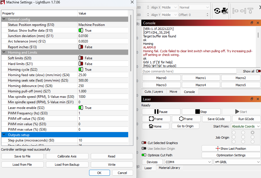

Alarm 8: It did not move off the Home switch far enough. Your $27 parameter =1, which is rarely enough. Try $27=2 or $27=3 to see if that makes a difference.
Set $21=1
$10=1 (for now, or 0)
$130=700
$131=350
Did you change any of these values or any other GRBL settings?
Also change width to 700 and height to 350, disable Fire button and post a screenshot of Edit > Device settings.
After the above changes draw a square 50mm side and laser the square in a piece of cheap cardboard with power just to mark. After that measure it and post the results.
