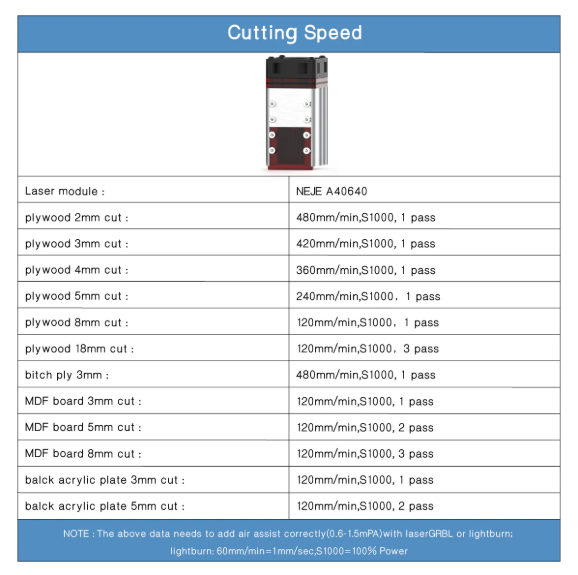

Today I received a form for setting from Neie Shop about how to set master 2s max for cutting. It is here as an attachment.

Your question is a bit unclear to me, do you use the list you have received with the reference/output values ​​directly for the layer you want to cut/engrave with, speed here in mm/min and power max 100% or do you mean something completely different?
I got this list from Neje, all the settings are there and at the very bottom of the sheet it is explained if you are using Lightburn software. I haven’t had time to try the settings yet, so I don’t know how these will work.
