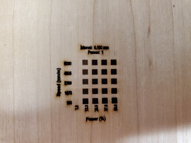

After doing a Material Test, most of the variation in shade is between 1 and 10, everything after 10 to 100 is dark.
How can I calibrate to have a more gradual color progression from 0 to 100% power?
See attached image.
Material test config:
Speed: 100 to 6000
Power: 1 to 50
Lightburn version: 1.7.08
Laser: Genmitsu CFL55 Compressed Spot Laser Module, 0.1mm*0.1mm Laser Spot, 5.5W FAC Laser Module for Genmitsu
Laser mounted to: CNC Genmitsu 4040-PRO
Controler: GRBL
$30=1000
S-Value Max = 1000
I’m learning - thank you for your help!
Marc
