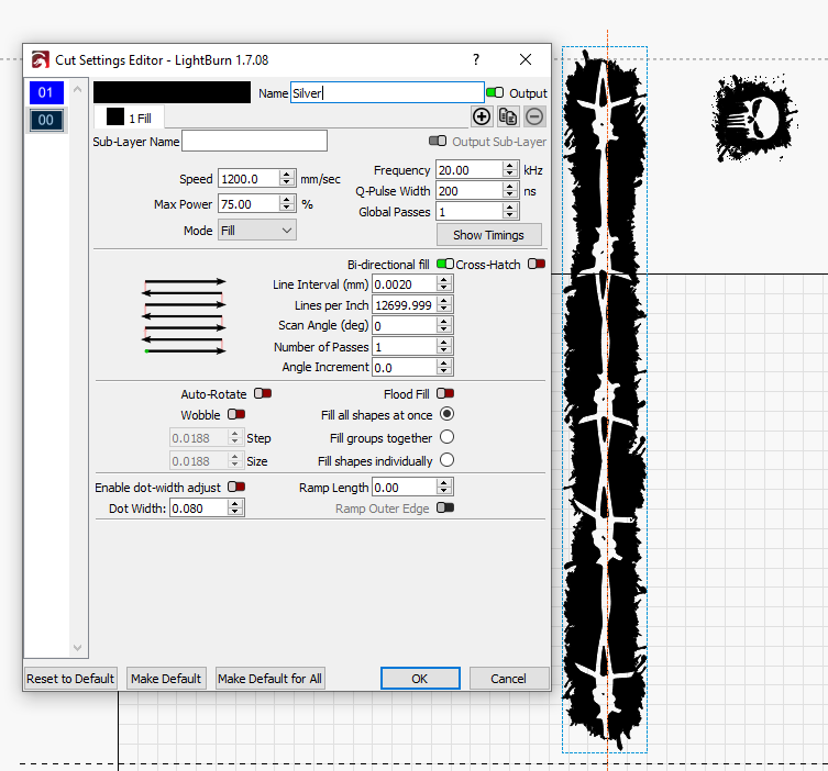

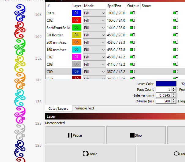

What laser do you have? Power? What are the rings made out of? My laser is 60W and I did some titanium rings the other day with the 175x175, came out good. (Might have been 110x110, don’t remember but 150x150 should be fine) This is my test file. Did some mexican silver rings, got a nice deep engraving.
Titanium, 1 pass
Silver, multiple passes and mixed up interval and splits to get a nice deep black.
Ok great thanks will try those settings .My laser is 50w power from Dowin laser. Focus is fine just have trouble getting a mark on silver or gold or stainless steel in rotary set up .Everything else is fine
