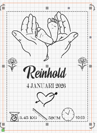

I engraved this image and want to use it again just change the name and other text. Can’t Ungroup it’s locked. How do I open it?
This could indicate that it is an image and not a vector graphic. If it is an image, you must first trace and edit it to be able to use individual elements.
Please send a screenshot of your layer settings for clarification.
Hi, Ok. I understand. I traced and changed the picture. Thanks again.
