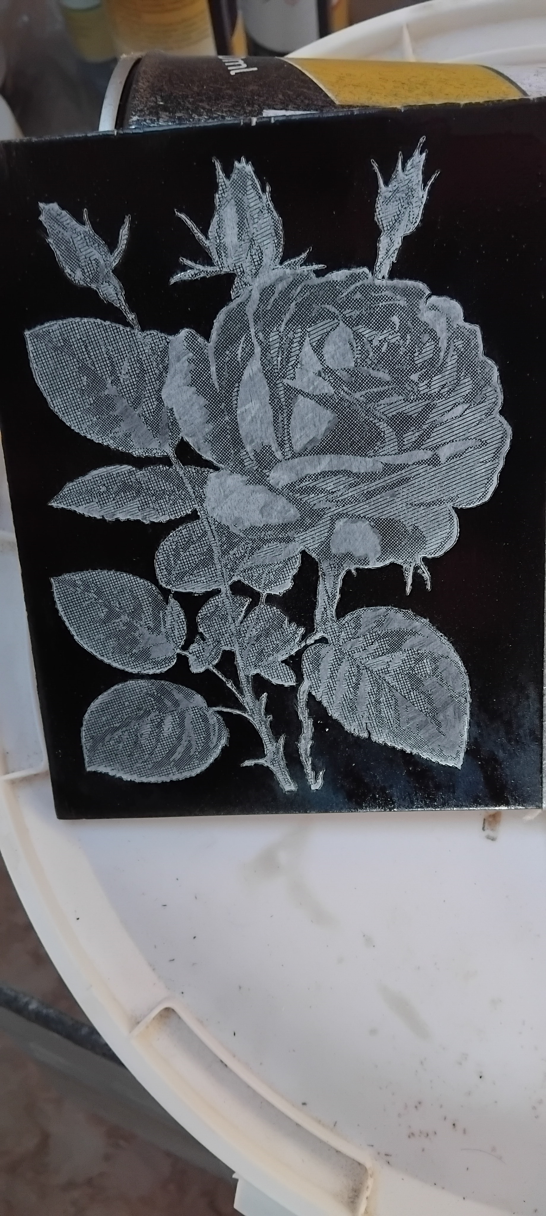

ednisley, Yes, my lasers ARE diode (I have TWO), AND I DO engrave on COLORED acrylic. While I mostly engrave on black acrylic (I make custom fountain pens and embelish black acylic and ebonite with BCHR style patterns), I’ve also engrave several colored acrylic pens.
! use a Ortur AL1 with a 1.5w module and rotary chuck for most of my pen engraving. But I’ve also used the 5w module to CUT (colored) acrylic parts. I also have a Ortur LM3 with 20w diode and 3w IR module, and I recently used the IR module to engrave on some BLUE acrylic. I’ve used the 20w module to engrave on several colors of sheet acrylic.
If you’d like to see some engraved colored acrylic, check out my colored theme pens at the link below (forum monitor: please remove the link if it’s not allowed).
Check out the LoR pen at the bottom (my lastest) with the colored acrylic windows.The windows are on BOTH sides and were all cut out individually with the 5w module (I came up with a secret trick to keep it from cutting through the other side).
