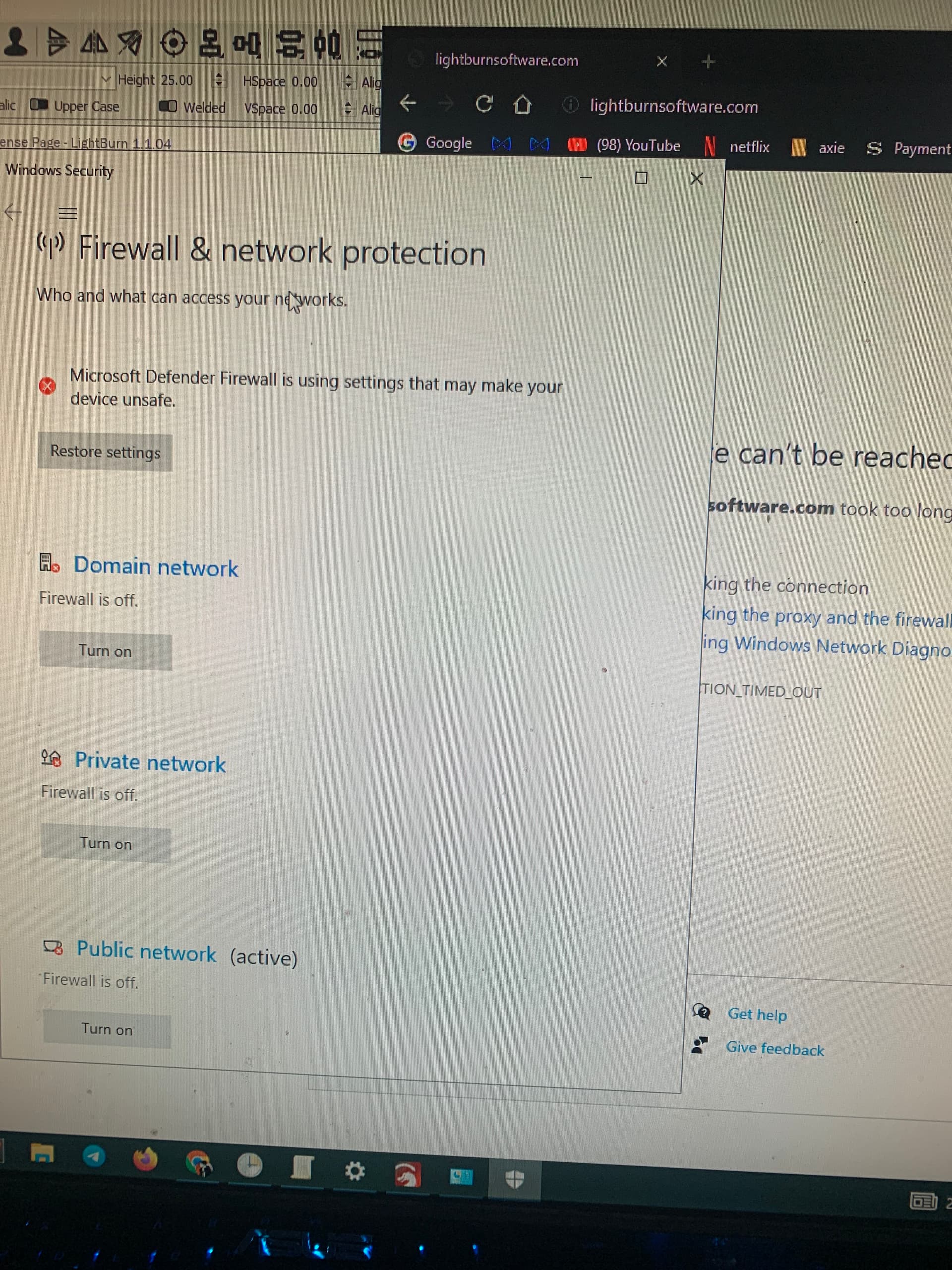

Now it’s displayed already sir but still same
You’ll need to be more descriptive. What have you done and what are you experiencing? Include a screenshot of what you’re seeing.

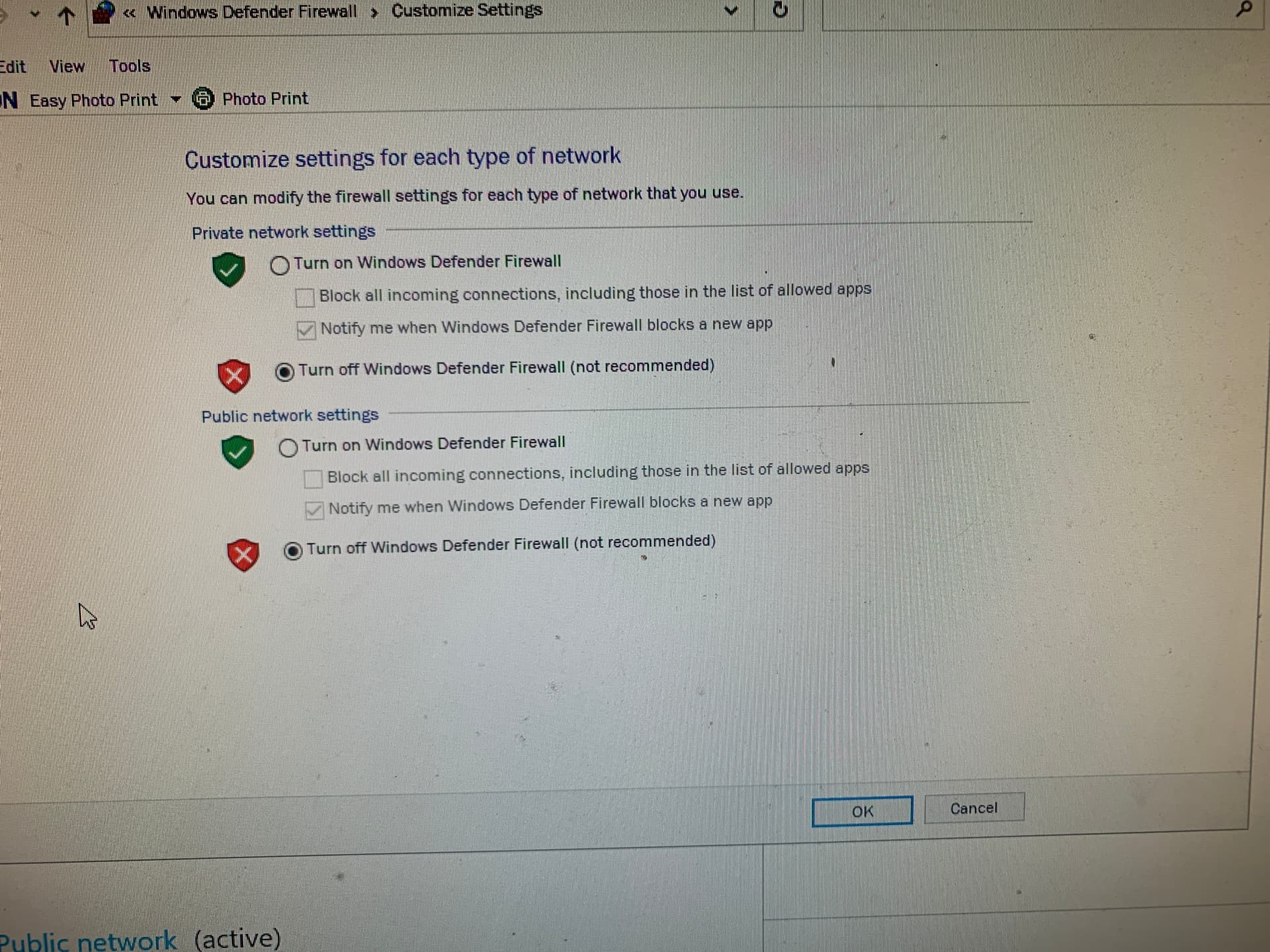

I have display firewall and windows defender and got same problem above that summary for all, as i said before I don’t know how to add api.cryptlex and port 443 because all topics before talk about that without mentioning the steps
Do you mean to say you disabled these? If so, how? Can you take a screenshot so we can see what you’re seeing?

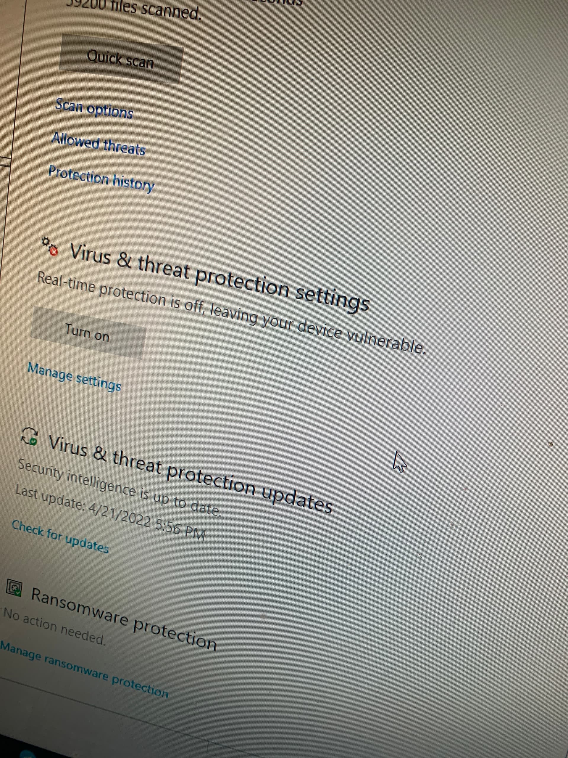

1st i close the Fire wall

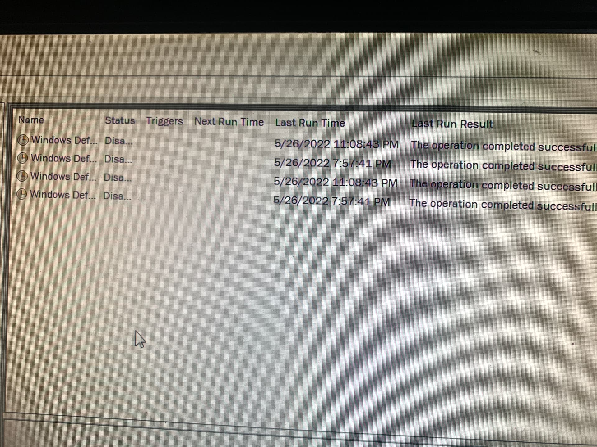

and close windows defenders
When I activate the license show as following:
