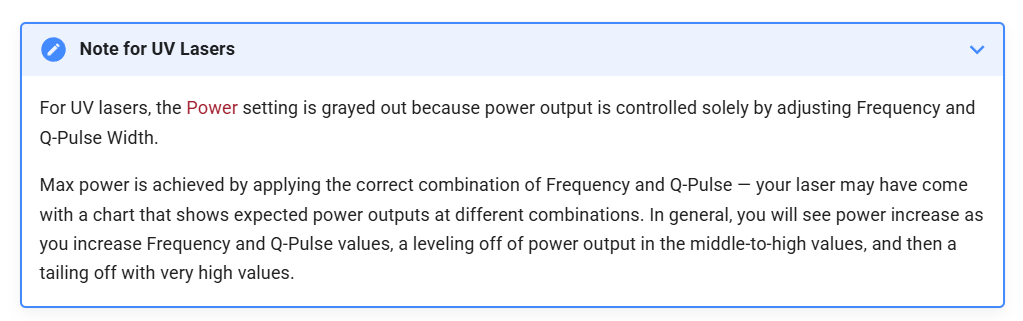

Hello, I have a problem. I bought a 10w UV galvo laser and installed LightBurn to test if it would work with it. The only thing that doesn’t work is changing the laser power; it’s grayed out and won’t let me change it. Does anyone know why this is happening?

If it is greyed out, that means it cannot be done on your laser. I think you vary the power by varying the pulse rate or something.

![image](https://forum.lightburnsoftware.com/uploads/default/original/3X/6/d/6d33c51b7b896345106a4a7f1512e2225cd02b40.png)
> **[Q-Pulse Width - Galvo-Specific Cut Settings - LightBurn Documentation](https://docs.lightburnsoftware.com/2.0/Reference/CutSettingsEditor/GalvoSpecificCutSettings/#q-pulse-width)**
> Several settings are only available in the Cut Settings Editor when working with Galvo lasers with EZCAD2 or BSL control boards. | Better software for laser cutters
