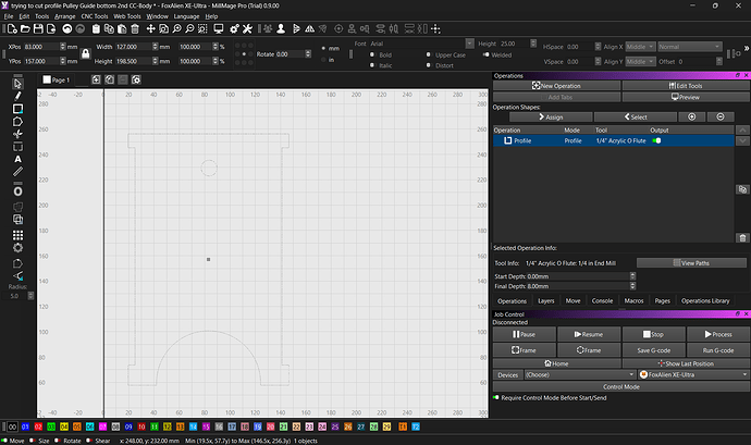

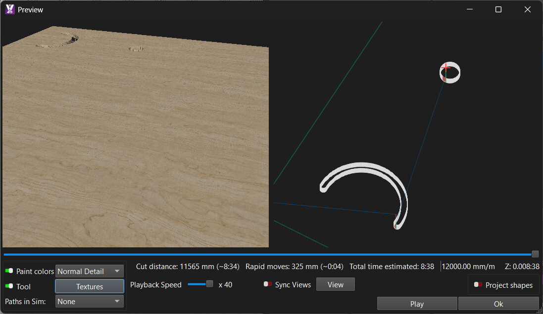

I can't get millmage proo (trial) 0.9.00 to cut a profile
I have been trying to get millmage to cut around the profile of a svg file. It only wants to cut part of the profile. I am not sure what I am doing wrong. Any help would be appreciated. I am attaching the screen shots of the operation and the millmage file, as well.
trying to cut profile Pulley Guide bottom 2nd CC-Body.mage (12.2 KB)

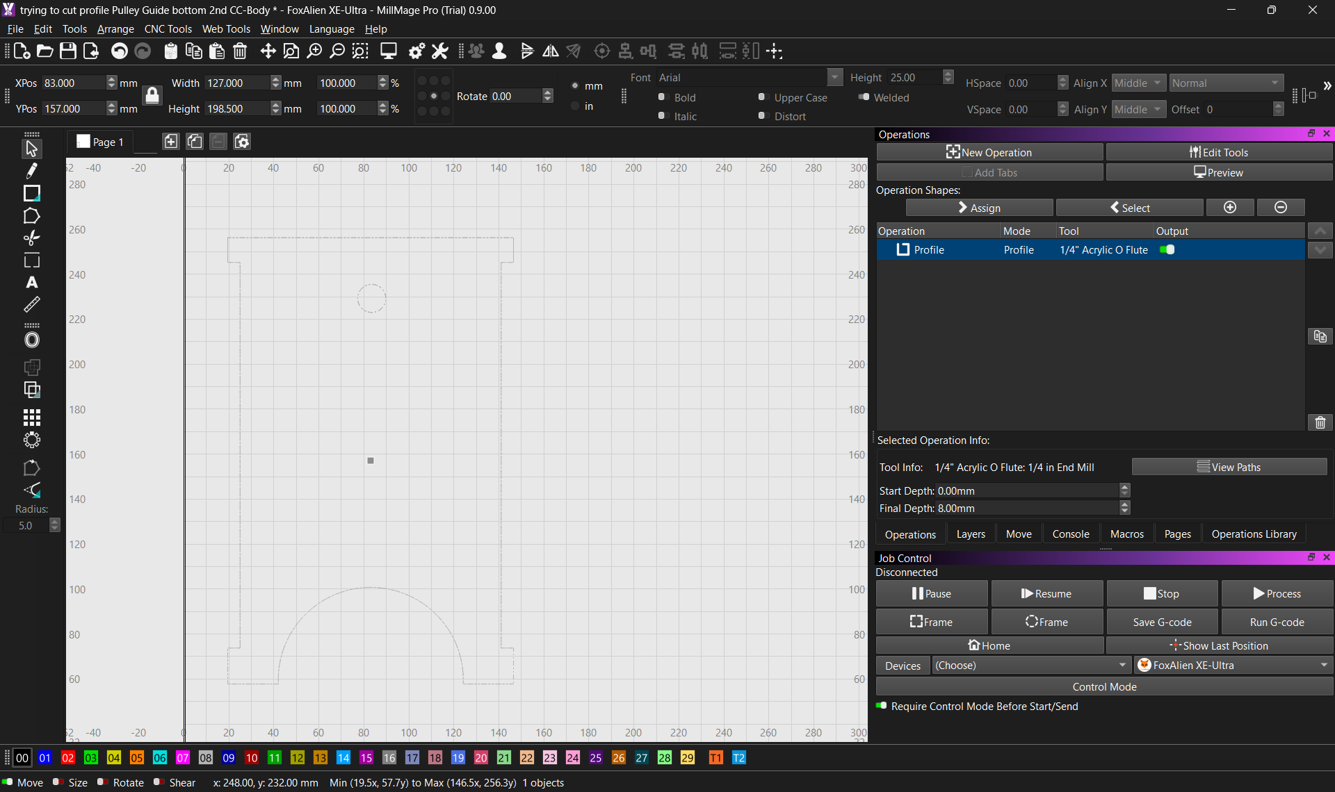

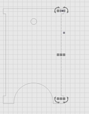

I downloaded your file to take a look. How did you draw the lines? I can’t join any of them to make the perimeter of your pulley guide one continous line.
I opened your file and found [1] the small circle had 3 of them, and [2] your outline was not a closed shape. A Profile cut must be on a closed path. I could not join the lines. Your original input file is the issue.
I made a snapshot of the preview window and used that for the operation. I think I got the output you were trying for.
Can cut profile Pulley Guide bottom 2nd CC-Body.mage (10.9 KB)
The part weas originally designed in freecad, i exported it as a svg.
Yes, that did the trick. Thank you.

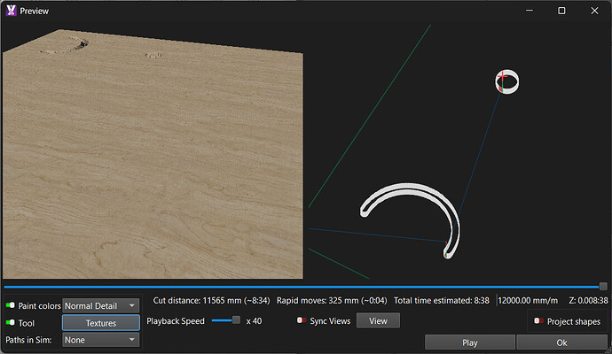

It can be Along the Line.
Right! That is why it was doing just the arc part.
