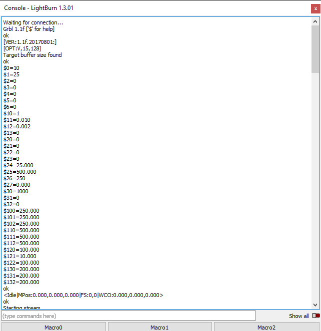

I got help that my wires were wrongly connected, but now that I have connected 3 stepper motors, they have different speeds and move different distances.
I’ve tried searching the forum about this but can’t find anything clear that helps me.
I post my “console numbers” and “machine settings” because I think that’s where you should change things.
right now the X at toggle one click goes about 1/5 of a turn.
Y rotates 5 turns on toggle one click.
Z at toggle one click about 1/5 of a turn.
Can you understand where I have the wrong code!?
And can someone explain where I should change and why, that is, so I can understand why I change right there :slight_smile:
I want to learn!
It is Arduino + CNC shield

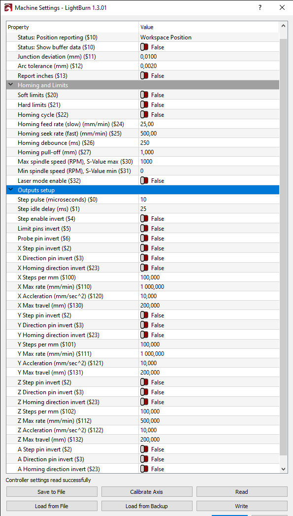

If you want to simply correct the calibration then you can modify these values:
$100, $101 and $102 – [X,Y,Z] steps/mm
More information here:
If you’d like to understand why and how this works I’d suggest you review LightBurn documentation on the subject:
Steps / mm - LightBurn Software Documentation

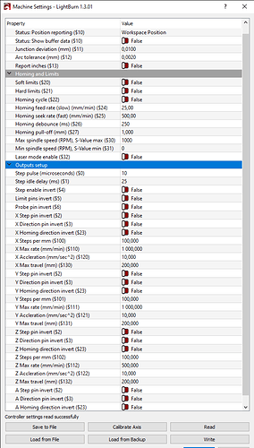

I don’t know, but no matter what I change in the settings in the console, I can’t get the motors to spin the same, is there any other place to change settings??
Try this as it might be easier.
  1. Design a square in LightBurn. The bigger the better. Make note of the size.
  2. Burn the square
  3. Measure the square
  4. Use Edit->Machine Settings->Calibrate Axis to tune the axes. You will need to provide the requested distance compared to the measured distance.
  5. Repeat this for each axis.

Okay. Then you’ll need to decide what you want to accomplish. It sounds like you don’t have a particular vision for # of steps per mm that you’re targeting. In that, you’ll need to just get the appropriate belts and gears for your laser, then you can calculate the required steps based on that.
Based on your config, it shows 100 steps/mm for all 3 axes. However, because you apparently don’t have identical stepper or stepper drivers, you’re not seeing the same motion in the steppers. The GRBL values are not a standalone means of getting you consistent motion. It needs to be calculated in combination with the other aspects that affect movement that’s included in the documentation link I listed earlier.
No. Steps/mm is irrespective of overall laser size. You could have the same steps/mm for a tiny area or a giant area.

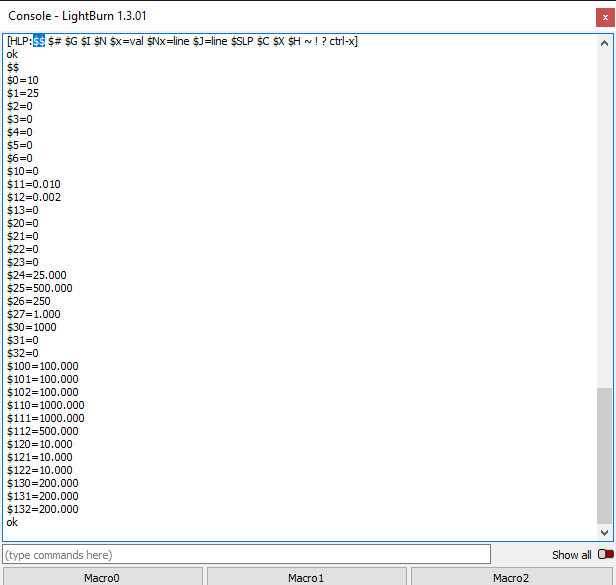

In that case it would be strange if these weren’t moving the same. How are you advancing the motion for your test?
What is the ratio of distance travelled for each motor when testing?
ok, to answer your second question: i just put the motors on the table with a tape on the shoulder to see how they move.
It seems that X moves constantly if I change “Speed” in the “move” console, the same distance as before 1/5, so 5 movements to make one turn, but different speeds. Same for Z.
Y, it spins 5 turns.
Speed is not a concern as that’s runtime configured. So sounds like they’re all behaving the same with respect to distance travelled.
Sounds like you’re good to go to proceed in that case.
