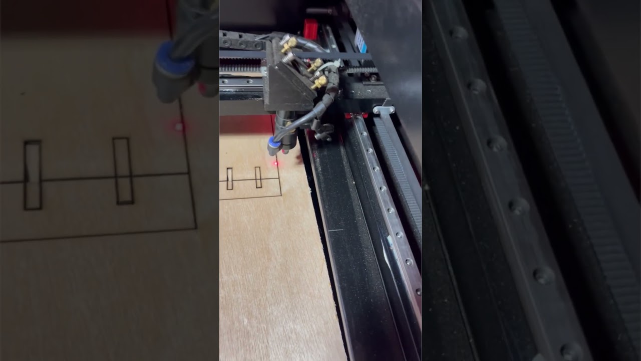

Here is something visual!
It makes a terrible juddering sound also.
It’s loosing steps, that’s likely the noise. Does it move easily by hand along the X axes. If it’s being bound up mechanically, you can’t fix it electrically.

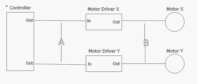

It goes from the step controls of the Ruida → Motor stepper driver → motors.

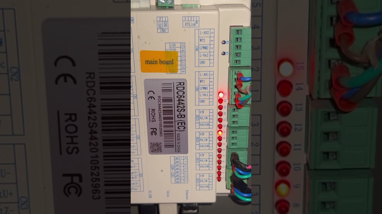

Check the motor stepper drivers for an error indicator on the panel. Mine are mounted upside down… I rotated the photo.
I have a 6442g and it has an error indicator, led 13, I think. Doubt it’s the Ruida.
These are usually the same motors/driver, so in theory you could swap them before or after the motor drivers… In other words you’d connect the Y driver motor output to the X motor and vice-versa. This would be where A and B are marked.
When you boot the machine keep pressing esc on the machines console to interrupt the boot process. Now you have control. Check and see if the noise follows the swap.
Make sense?

This video is the main board with warning lights.
Just when I REALLY need the blumming thing
They are not error lights. The legend is covered by the main board sticker.
led15 shows it’s producing 5V, the run light (led14) just flashes and led9 indicates there is coolant flow.

Some more video, here is where it refuses to play nicely on the Y axis.

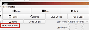

Have you used the rotary lately?
You might still have it enabled, and your machine thinks it’s controlling the rotary when it’s hooked up to the Y-Axis instead.
If that’s not the issue, I recommend following Jack’s suggestion here. See, if the problem moves to the X axis when you swap the motor connectors.
