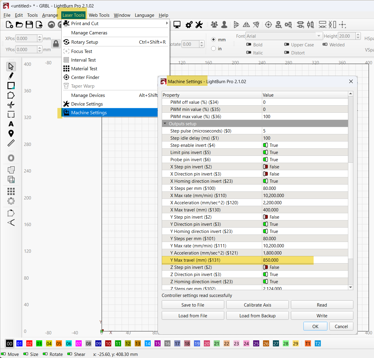

Hello, i have an problem
Laser ray 5 20 wat whit bed 40x850
iv i ask frame i get ;
Starting stream
ALARM:2
G-code motion target exceeds machine travel. Machine position safely retained. Alarm may be unlocked. (Right-click the ‘Devices’ button to reset the connection)
On or near line 5:
Stream completed in 0:02
SimpleLaser 1.1h [‘$’ for help]
[MSG:‘$H’|‘$X’ to unlock]
\<Alarm|MPos:4.938,197.500,0.000|FS:0,0|WCO:0.000,0.000,0.000\>
[MSG:Caution: Unlocked]
ok
ok
\<Idle|MPos:4.938,197.500,0.000|FS:0,0|WCO:0.000,0.000,0.000\>
what have i wrong in the settings

Hi Jan,
Make sure the correct bed size value of 850 is present for ‘Y Max travel (mm)’ in [Machine Settings](https://docs.lightburnsoftware.com/latest/Reference/MachineSettings/):
 ![image](https://forum.lightburnsoftware.com/uploads/default/original/3X/f/c/fcce430fb0ae7d8de65e6e208224cf0b17e2a652.png)
