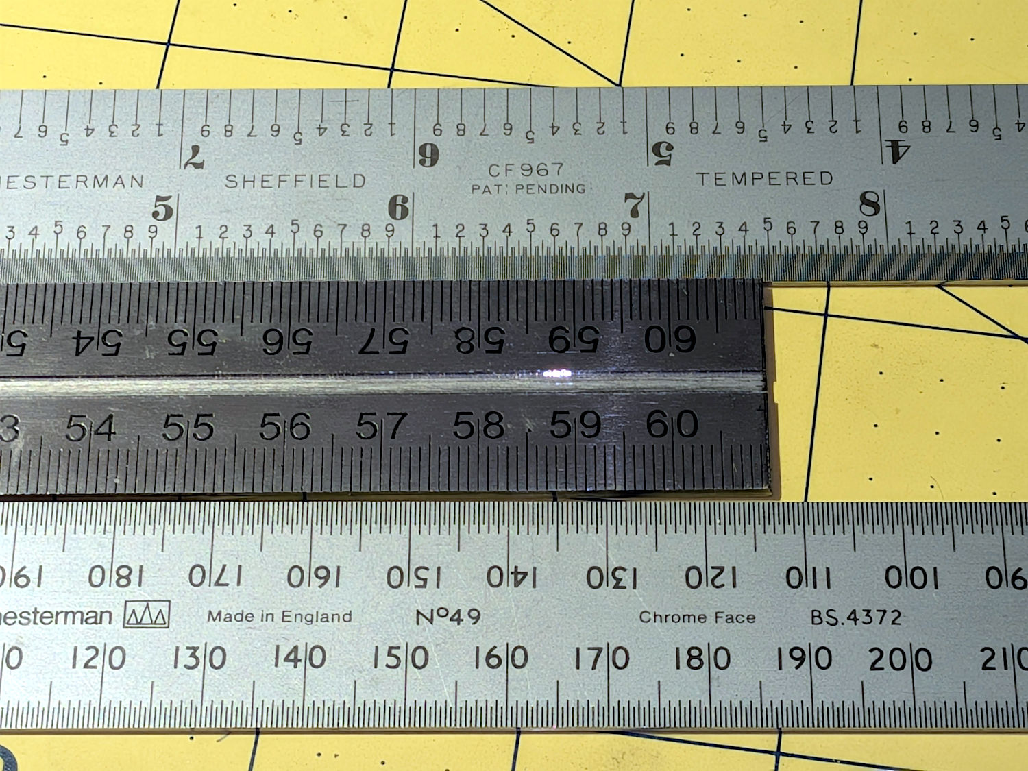

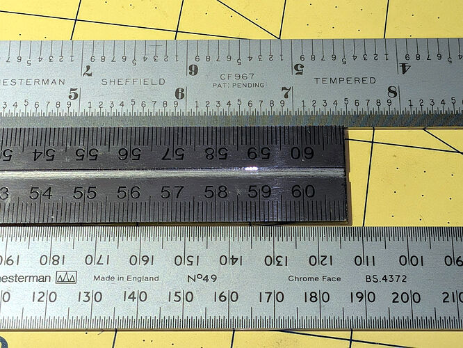

You can also use a steel scale:
I like @ednisley tip, marking a square on material rather than cutting through is best practice.
That said, I don’t think I’d ever take the steel scale out of a combination square :laughing:
That’s the longest “good-enough” scale I have; its 24 inch / 61 cm length let me run the X axis almost all the way.
In my defense, I matched its marks against what serves as a reference scale around here before depending on it:
Given that I’m a USA-ian, those Rabone Chesterman scales were a surplus find, back when you could get good stuff cheap.
