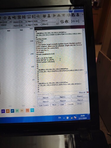

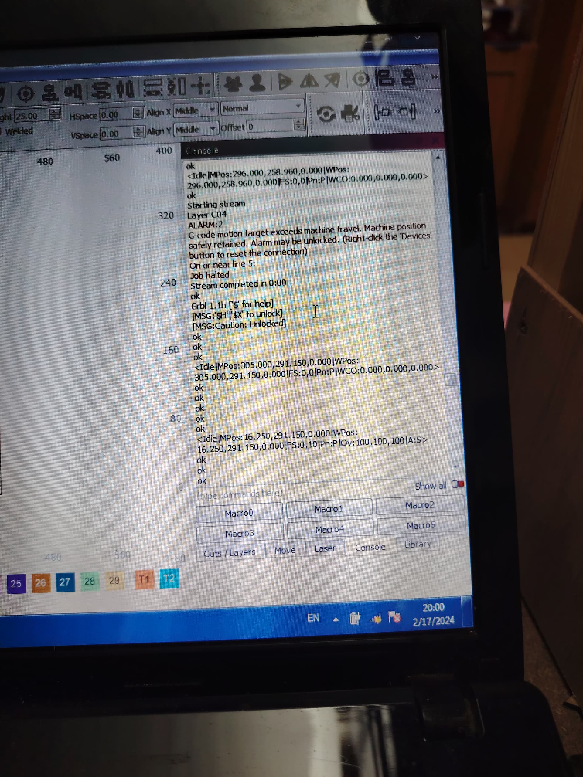

I have a problem with same program a created and done some work with that files from some reasons my machine stop evry time in same spot but dont evry time idk why is that
And i make sure that is in machine work space and do double checkbwith frame
If you have Overscanning enabled in the Cuts window, you may be going out of bounds. Speeding it up can make this happen on good projects. Turn on Show traverse mode in the Preview window to see it.
