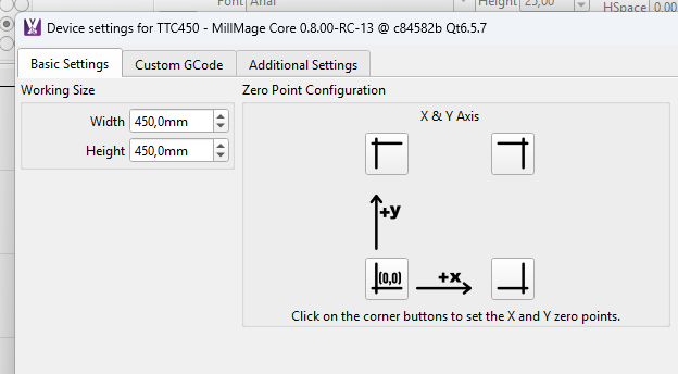

I hope I am just missing something, machine coordinates home to -377, and how to center using origin like lightburn?
I have a FoxAlien Masuter Pro (400x400). When I home, the machine cooridnates for x/y go to -377 and the workpiece coordinates go to 0. Once I start the process, the machine tries to go to the positive coordinates and hits the upper right limit switches.

Any help is appreciated. (I already tried changing the origin in device settings).

Did you check these options as well?
So, the reason that MillMage and LightBurn differ in how they handle coordinates has a short and long answer. The short version is:
MillMage doesn’t really care about machine boundaries. It only cares about the workpiece boundaries. In the startup wizard, when you give it a dimension for the blank, that is what your project will be.
So the workpiece and machine coordinates almost always differ.
Most GRBL-based machines (and I believe the FoxAlien machines use it) will have the machine 0,0 set up in the top right corner on the screenshot provided by @misken .
Even if the homing switches are in the bottom left, if those values are negative, that means the 0,0 is in the top right.
The workpiece coordinates will then need to be set depending on what thickness your piece is, and what diameter bit you use as well. (Ideally you offset by half the diameter so your bit centerline is on the edge of your blank.)

Thank you all for the input. Although my mind still does not like the negative numbers for home, so far most of my stuff is ‘object center’ based. I realized that if I choose the project origin as center, then center the bit on the workpiece and set origin, it works like it should. I got so used to the ease of Lightburn…
